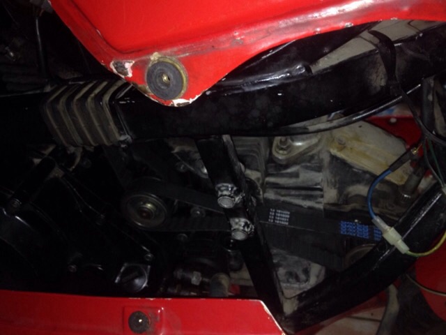

Hi Léon! You were spot on. Digiplex ignition and gold valve covers. Found oil pool on garage floor. Oil swepping from oil inspection window. Waiting for cam belts (30€ both). Meanwhile oil wire mesh filtre clean, oil filter changed and ignition flywheel point window swapped with the oil one.

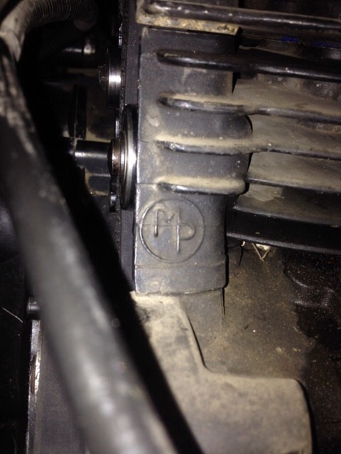

Belts changed. Tensioned with 6&5 Allen keys method. BTW MP sign on block as I saw in a post. How do I connect Holley pressure regulator. If answered my question I promise some pics. Methinks

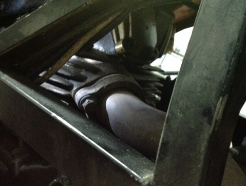

I think fuel pressure regulator must go after the t connection in the carburettor line. One pic of the pistón sign?

Found¡ MP sign is the foundry trademark where cylinders block was forged in 1988. Nothing to do with Mondial or Malossi pistons.

Hej Balarrasa, nice pictures. I've been offline for a couple of weeks. What's your question about the fuel pressure regulator? You have a problem with electrics or the fuellines? Never had any problems with mine, but changed the fuellines last year. I think your gastank has two little pipes sticking out on the end. One with the fuel return-line and one line for overflowing. Overflowing is just hanging there with an open end. Furthermore I've noticed that you're missing the right side coil. Suppose this was removed due to the belt change?
Be sure to give the clutch some maintenance. The little cap in the bearing (in the clutch cover) must be checked now and then.
Nice to know maybe is that you have the stronger casing then the older paso's. The one's before enginenumber 4000 or so have problems with the bearing near the second gear. This is a bronze bushing that will sooner or later fail and could destroy the gearbox. It seems you don't have that problem.

If you have a T connection in the fuel line, it means your tank has only two pipes, one with the petcock and the other for the vapour outflow. Otherwise the tank has another pipe for the fuel return.
About the MP logo: I was told that Mondial built some stock of pistons but it was not the only one supplier. I don't know if Mahle kept suppling after 1987 but big bore were done starting from OEM cylinders such as MP or tecnol and so on.
