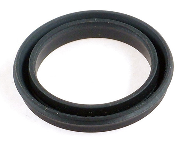

93040091A is a V shaped seal and imo already better than the old o-ring. I think I`d prefer that to a square ring.

doing a search on the dimensions brings up a lot of "X" or twin lip seals of similar dimensions
Maybe these guys can fix you up :beer:
