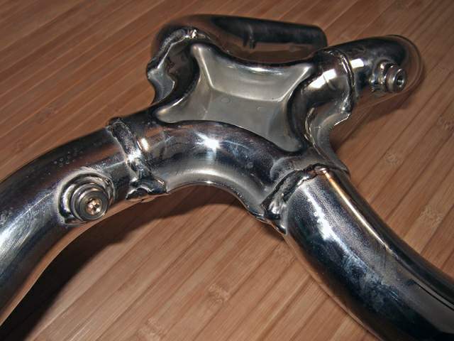

So, I bought these new headers on the internet. they have these threaded holes in them (pictured above) which my original did not have.
My original had a hole in it, that's why I needed a new one :) but not threaded....
Any ideas?

some headers had connections for a gas analyzer.
The thread should be a R1/8 (conical).
The old plugs were #000047113 (now 78010091A). Not sure if #78010071A is the same.

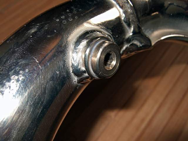

my header

thanks. conical thread huh... the things you learn...

and thanks for the part number. The local dealer had them in stock. :D

got the washers, too? Applying some anti-seize is recommended.

use a copper washer

that should be ok, too. It should just be a washer that also can seal.

aluminum will work and are readily available

you want that bolt to sit airtight so you use a washer made out of a softer material than steel
