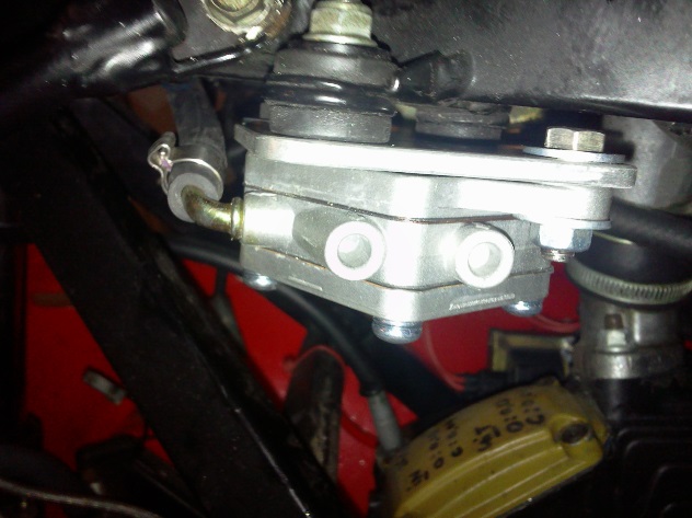

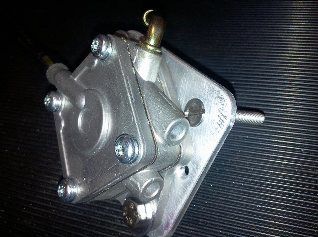

Here some pictures of the vacuum pump modification. Return line to the tank is eliminated. Startup is much approved. I'll have to test the setup of mains, idle jets etc. again
File comment: old pump
File comment: yamaha vacuum pump fitted on homemade alu bracket
File comment: new pump fitted

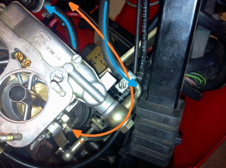

Here the new lines installed. The orange line is the vacuum from the right side of the manifold to the pump. The blue lines supposed to be the flow of fuel from tank to pump to weber.
Léon

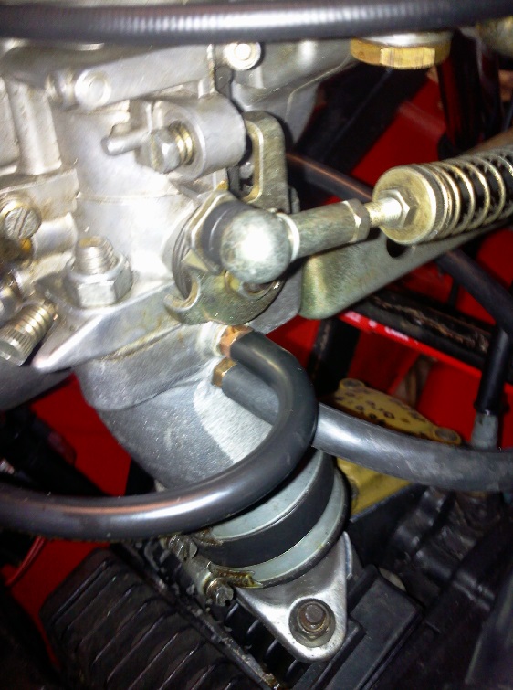

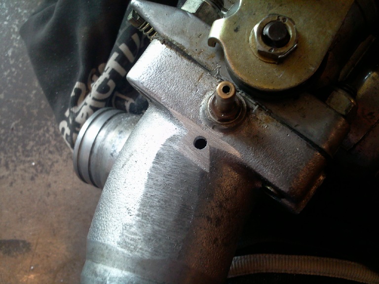

I couldn't resist to have another go at the manifold. Below the current setup. Drilled a hole and fitted a third tube for maximum vacuum to the pump. I was considering to drill out the m6 bolt as shown in drawing above, nr 56. As you probably will know the left one goes through the manifold into the channel. I have a lathe, but this small tubing is a b%tch to create myself.
