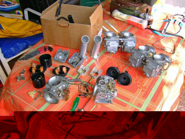

I`ve been playing with three Mikunis myself yesterday and today as it`s finally nice and sunny outside.
As a consequence and as experience proves itself again I have to say something to all that plan a Mikuni conversion and get used carbs from ebay or anywhere else. Before putting the carbs on the bike disassemble them and write down all jets and needles. Most sellers don`t even seem to know which bikes they are from. :wacko:
I recently bought one from ebay that was said to come from a 750SS.
As I made myself an Excel sheet long time ago with the jetting overview of Monster/SS/Elefant I can usually determine quite fast which Duc/Cagiva the carb actually came from and if the jetting was right. In this case though the needles were 5C17 instead of 5C19, the main jets were 132,5 instead of 140 and the main air jet which should be a 70 was a 49 on one side and 73 on the other :banghead:
The next thing is that right next to the membrane there should be a small o-ring (#9 Tav.19) (not on the Mikunis coming from a Yamaha TDM/TRX). These were in place but before the spring of the idle mixture screw there should be a tiny washer and an o-ring (the o-ring has an inner diameter of 3mm and the washer just protects it from the spring). The o-ring and the washer were missing probably in 7 out of 10 carbs I rebuilt. (they are #11 & 12 on Tav.18 of the Monster parts catalogue)
So always take a close look, you never know what the last owner(s) did.
They might have lost the parts while cleaning the carbs or forgotten them on the workbench when reassembling them. Who knows. Always check yourself !
