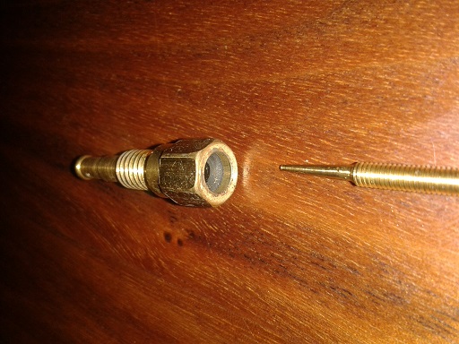

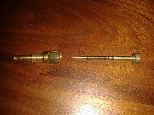

Have been busy with work, so haven't done much on the paso lately. Here a couple of pictures of the adjustable idles I received. Seems stock mid eighties of a Fiat. Nice quality with an rubber gasket fitted inside. Due to this rubber it takes some force to turn the needle. I recon this will keep the needles at the right setting:
