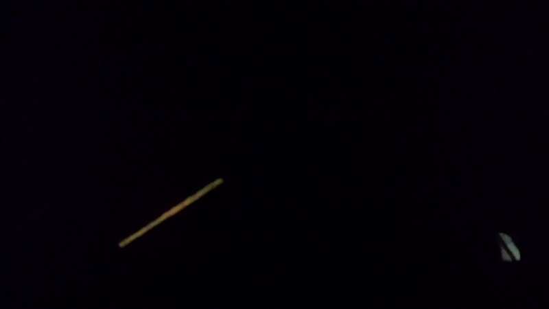

Has anyone come up with a way to make the instrument needles more visible at night? I've cleaned up the lighting part but when riding at night the speedo and tacho needles are pretty much invisible. Has anyone found back lit needles or played with repainting the needles themselves?
 Post subject: Re: LED dashboard conversion
PostPosted: Sun May 31, 2015 9:42 am
I had thought about that and there are sets of illuminated needles for cars you can buy but it`s quite an effort to install and then not all instruments will have the same needles which I don`t like.
Other options:
http://scootrs.com/moreinfo.cfm?Product_ID=2143
http://www.hiluxsurf.co.uk/showthread.php?t=73732
http://www.ebay.co.uk/itm/VW-GOLF-MK3-V ... 1217047160
There are also things like fluorescent paint but I have no idea how good they work and if at all or only with UV LEDs like the ones above.

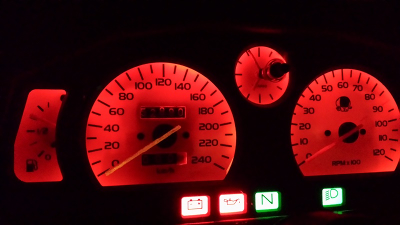

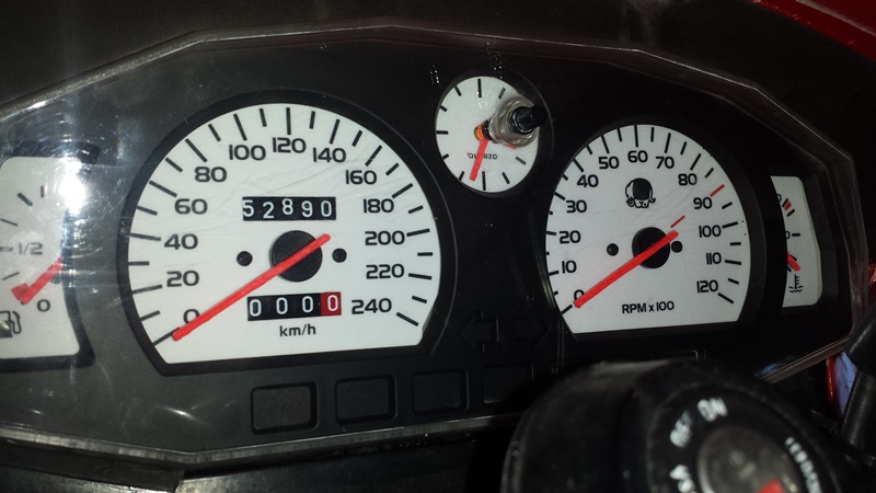

PostPosted: Thu Jun 23, 2016 3:47 am
Posts: 89
