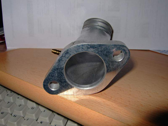

Middle of inlet manifold, that`s what Ducati did themselves.[quote][/quote]

Hi Frank, I´ve installed it on the manifold:
viewtopic.php?f=1&t=7127&hilit=digiplex
