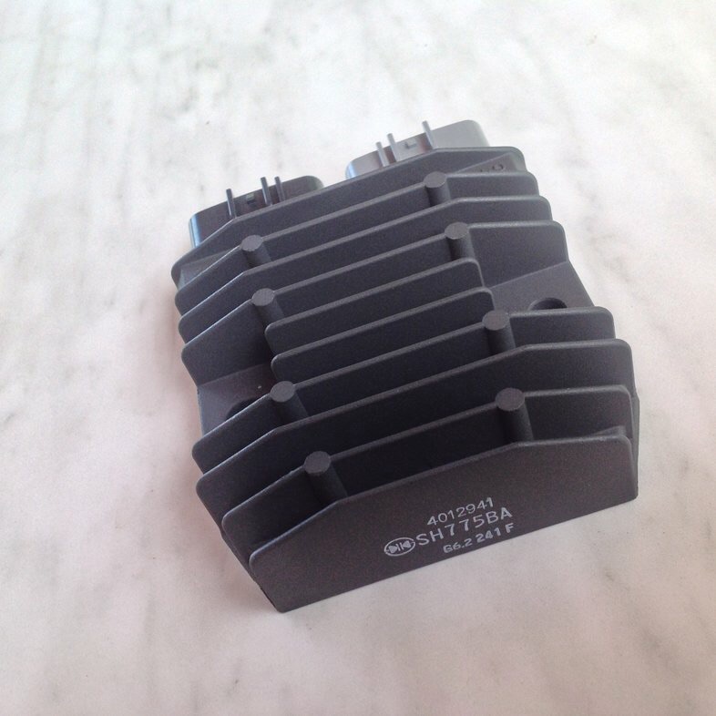

Hi,
Bought myself a brand new, original Shindengen SH775 serie regulator/rectifier in the hope it will work. :fart:
All remarks, reviews & advise that I've read, have not convinced me it will but I will inform you if it is plug & play or not. :wacko:
I've got 2 yellow and 1 red wire coming out of the stator.
Also not sure how to connect the output wires (original has 3 positive connections, the Shindengen only 1).
Tempting to take the 3 together but not 100% sure yet (anyone?).

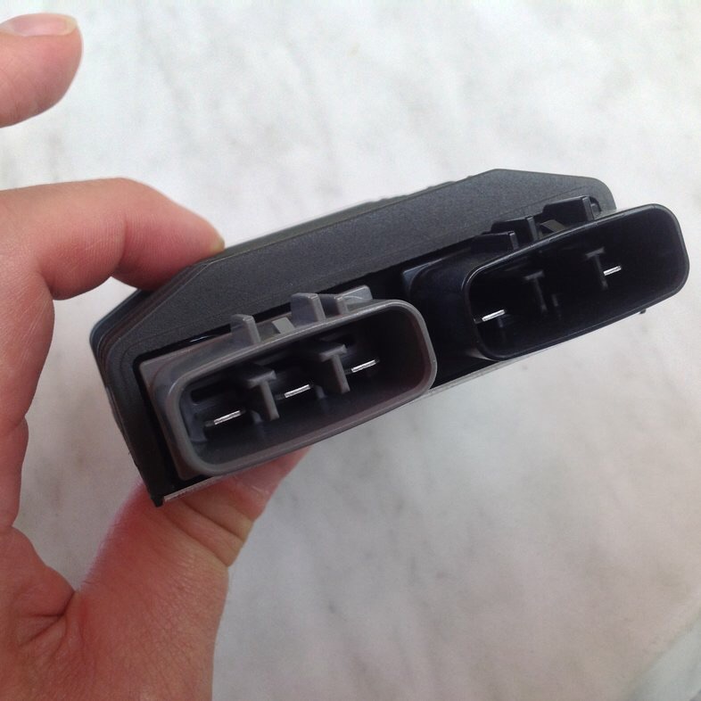

1 question though: does someone know the name/type/brand of the 2 connectors used on the Shindengen R/R? :?:
Need to have them and I would like to get them somewhere from Europe (to avoid customs - cost & handling fees, the original SH775 was already quit expensive).
File comment: SH775 R/R (Polaris)
File comment: SH775 serie Shindengen connector side
 Post subject: Re: Shindengen SH775 serie regulator - connectors
PostPosted: Fri Sep 23, 2016 1:19 pm
http://www.cycleterminal.com/furukawa-qlw-250.html
you should check local jap bike or Triumph dealers. They may sell them, too but of course under their own part number so it would make sense to visit personally and take the regulator along.
PostPosted: Fri Sep 23, 2016 1:31 pm
Triumph #T2500676
PostPosted: Fri Sep 23, 2016 10:14 pm
has everything you need to know and can sell you the connector-terminal kit for 20USD
Almost all bikes made these days use these regulators as well as snow mobiles etc
they hook up just the same as any other regulator

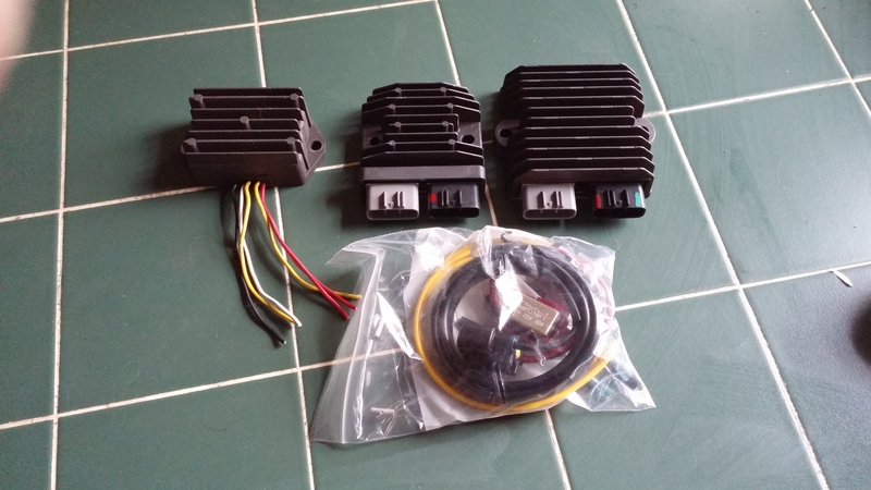

PostPosted: Tue Oct 25, 2016 4:06 pm
The electrosport :drunk:
The FH series :thumbup:
The SH series :beer: :beer: :thumbup:
The FH/SH connector kit :thumbup:
PostPosted: Tue Oct 25, 2016 4:24 pm
Posts: 261
Hi ordered the connectors in the US and received them last week.
Only disadvantage is that we (in Europe) have to pay extra handling costs due to customs.
Still not sure how to connect the R/R and the original wiring loom but that's for later.
Higgy, do you have the serial R/R connected?
PostPosted: Tue Oct 25, 2016 6:12 pm
I have tried them all, ask away :beer:
