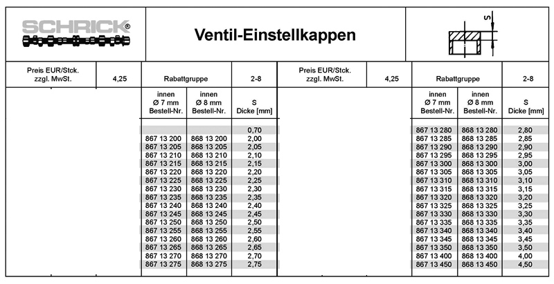

Schrick cams in Germany also list 8mm valve hat shims.

Great find G. I do a lot of shimming work on Ducati engines for other owners here in Scotland. Having an alternative source at better pricing is fantastic. I see on the Schrick list that shims for 7mm valve stems are also available. These may fit the 4V engines. It will depend on their outer diameter and the depth from the shim face downwards.

I sent an enquiry to AVL-Schrick and to http://www.maxrpm.de/, one of the shops here in Germany which sell the Schrick shims. Got no reply from Schrick yet but the owner of the shop sent me an email yesterday.
He wrote that from the open side to the bottom it`s 3mm (hence total shim height would be 3mm + "s" the thickness). The outer diameter is always 2mm greater than the inner diameter. As the shims were developed for tuned and competition engines the surface is hardened.
I wasn`t sure about the latter because other than on the Duc engines in cars the shim sits between the valve and a cup. It`s not in contact with the camshaft which is why I asked.
The Duc opener shim I measured also has 3mm depth and the outer diameter is 11mm. It seems its skirt is 0,5mm thicker (unless the guy from the shop measured incorrectly). Don`t think that makes a real difference.
I might get some the next time I need shims. EMS in the US sell opener shims for $8.50 which is a good price but in my case it`s plus international shipping, import duties and the time for them to get here.
At Stein Dinse they cost €12 ea. The Schrick ones are sold at maxrpm for €5.50. Just considering one would buy one of each size (32pcs) that would be €384 vs €176.
Actually it`s strange that at SD the 8mm 2-valve shims cost €12 while they sell the 7mm 4-valve shims for €6.40.

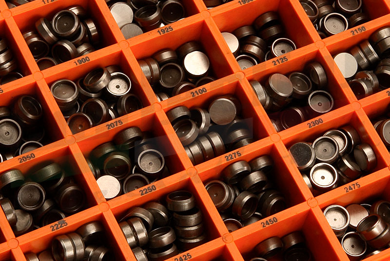

last update: I had posted in an Alfa forum to ask about the dimensions of the original Alfa Romeo (Twinspark) shims and they are od 11.5mm and 2.5mm depth.
They come in 0.025mm increments.
