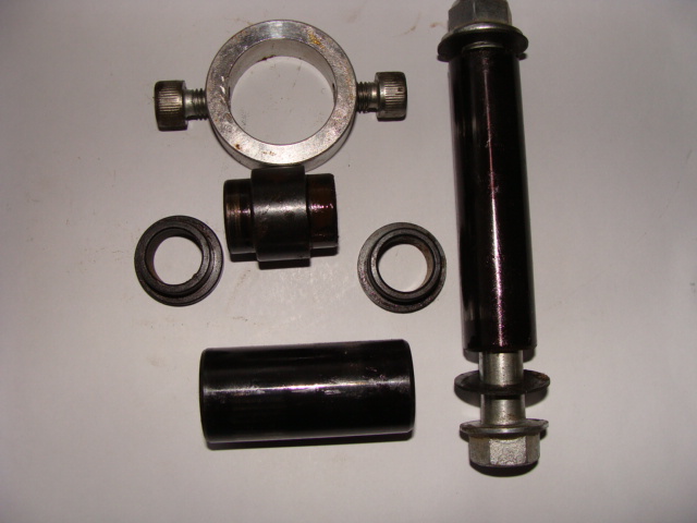

While we are talking swing arms its probly worth taking it out just to get a coat of fresh grease on the pivot bolt ..... assuming it hasn't already seized... and to regrease the bearings in there too
The big bush ( bottom centre ) is the inner race for the needle rollers on the left side , the pivot bolt can seize in this bush , and the one above it (with the two smaller spacers is the spacer assy for the rhs ball bearings which can do the same but not usually as bad. :)
