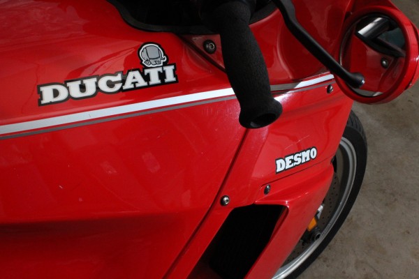

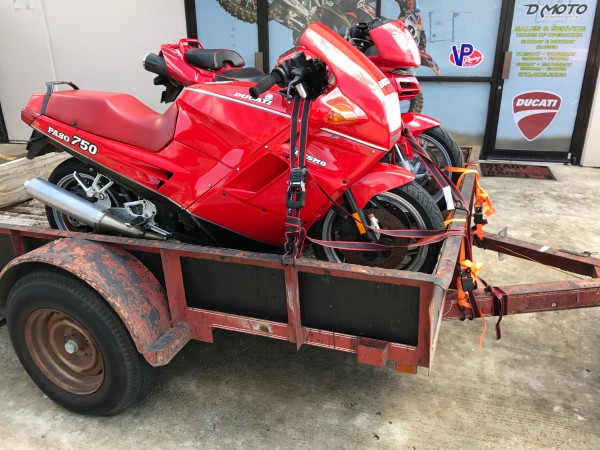

Hello all from the great state of TEXAS! Here are some pics of my recent purchase (about 4 weeks ago) from a craigslist add. I had 2 weeks earlier wrecked hard on my 04 Multistrada 1000 ds, and was looking to have something older to work on when I found this beauty!
File comment: Day after I bought it, checking on parts
File comment: Got it running yesterday! 1988 750 (non calif. model from what I gather), one of 55 shipped to US in 88

I like the trailer :D ( and the bike :) ) , looks like a real Kiwi home made job ( that's a compliment :) )
Welcome to the madhouse
