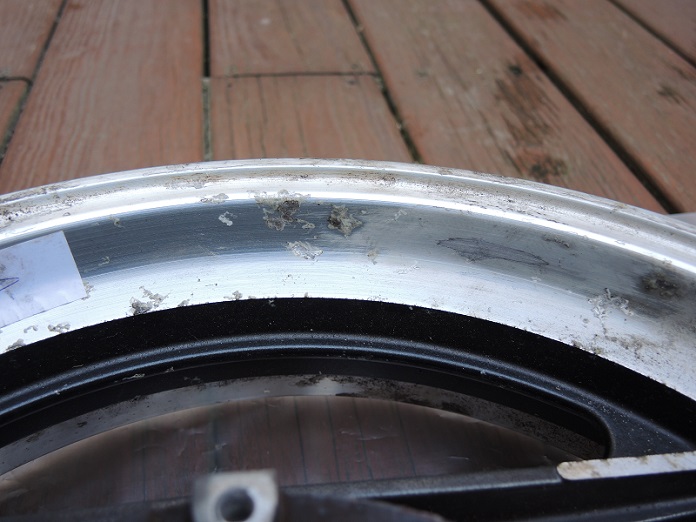

- Strip the clear lacquer on the spots where there’s no black paint (or red in case of 750 Sport rims). If you use a small brush and apply the stripper
carefully, you can get a very sharp line between the black area and the transparent one
- Carefully remove the blistered lacquer by rubbing with a smooth metal sponge and some water
- Sand the edge between stripped and non-stripped area with waterproof sandpaper (first 400, then 800) to make sure there is no height difference
because of the removed lacquer
- Take a Scotch-Brite hand pad (a smooth one, I took the wine colored one) wet it with water and sand the black hub and spokes. It will get a bit
dull, but don’t worry. After respraying this area with clear lacquer the black paint will regain its depth and also the metallic particles will be clearly
visible again.
- Sand the stripped area with waterproof sandpaper and some water (starting with grade 400 ending with 1200). If no too deep, damages can be
sanded out. Polish the stripped area until you have a nice, smooth and even finish. I got a very good result by doing the last polishing round with
the Scotch-Brite and some water.

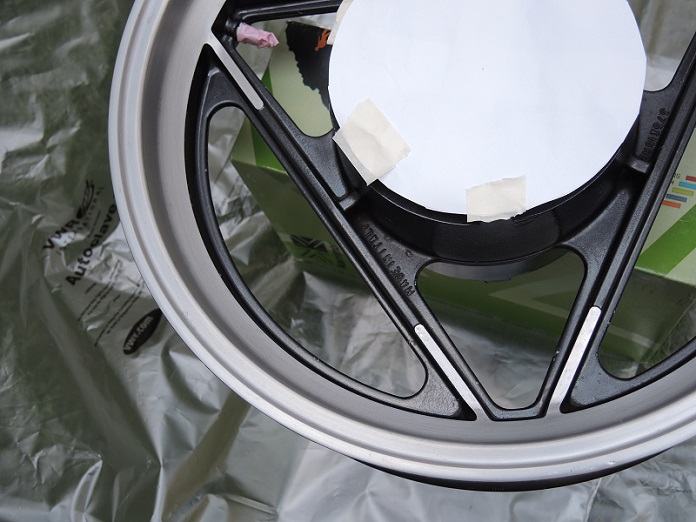

- Cover the parts that you don’t want to paint. I choose not to paint the sides of the hub (where the bearings are situated)
- Degrease the complete surface that you want to paint with a good paint degreaser

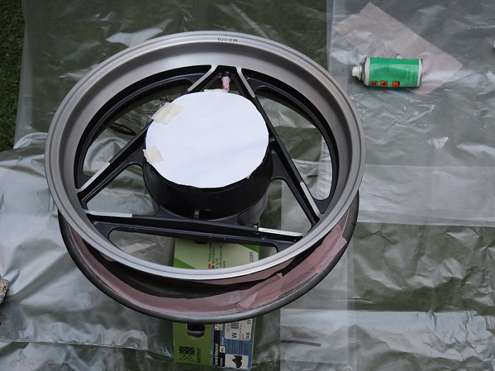

- Position the rim so that you can easily spray paint it. I put it on a shoe box. As I did not paint the inside of the rim (where the tyre is mounted) I
could easily turn the wheel around and paint the other side.
Step 4: Spray paint
- 2K clear lacquer in a spray can: Spraymax 2K Klarlack http://www.spraymax.com
This product was quite a revelation to me. A two component product in a spray can, so easy to apply and not expensive (around EUR 20,- for a 400
ml spray can, which if you take care is enough for both wheels). Further, after curing the layer gets very hard, which is perfect for rims of course.
- Prepare the spray can by adding the hardener to the paint (see instructions on the spray can). You must use the lacquer within a restricted time as
the curing process will start immediately (If I remember well, within 48 hours)
- Spray a few thin layers after each other, leaving each dry for 10 or 20 minutes in between. Be careful, don’t apply too much paint as what comes
out of the spray can is quite thick! Further, this product really stinks, so use a proper respirator.
- If you let the lacquer cure for a few days, fitting new tyres is no problem.
Result: see pictures below! :lol:

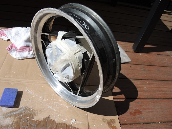

Some more pictures

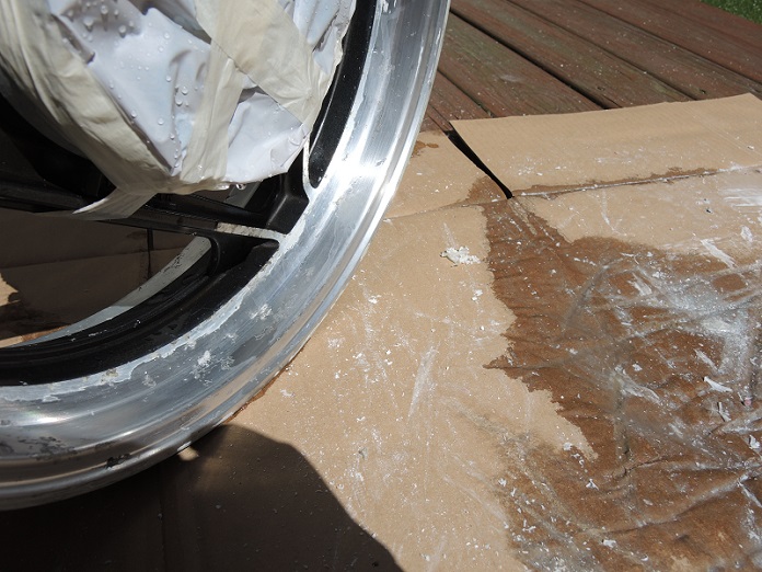

File comment: Paint stripping in progress

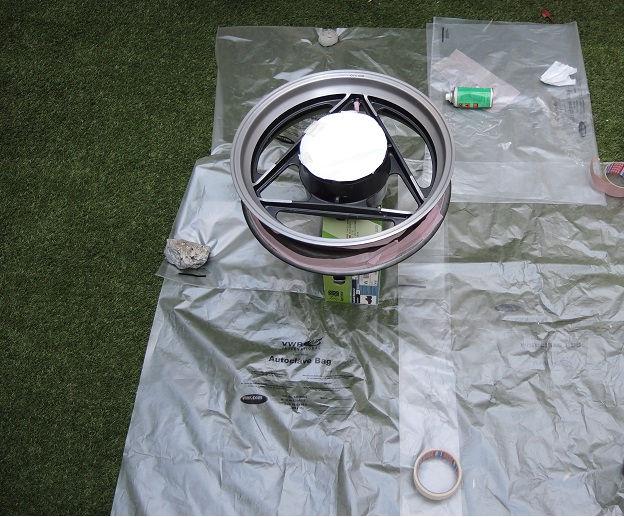

And some more pics of the painting process

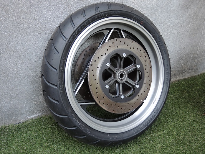

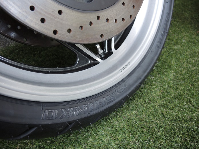

Final result
