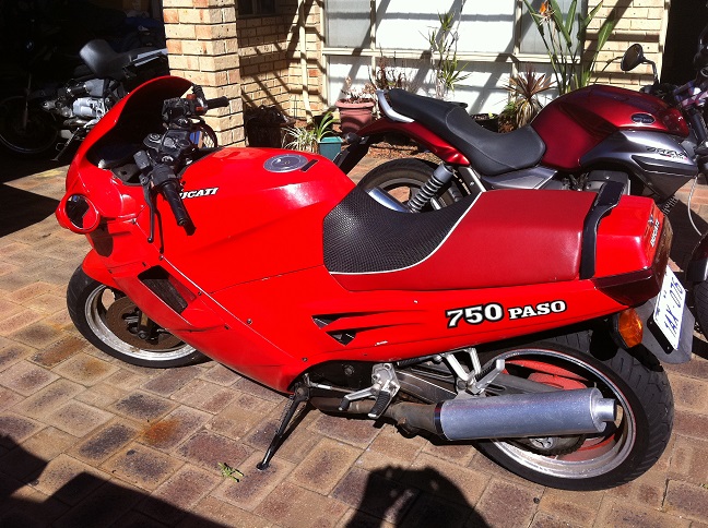

New to forum. I have a 1987 750 Paso with Dellorto carbs. Not sure of size but will check. I have just had them cleaned and re kitted by a local Ducati mechanic. The bike sat for 12 months previous to this so they were all gummed up with old fuel and crud. This past Sunday I took the bike on a 200km run to a motorcycle festival and have found that I'm having a few problems with them.
1/ There is a strong smell of fuel coming from the exhaust and around the general area of the carbs when idling.
2/ The bike stalls sometimes when parked at traffic lights.
3/ The engine seems to run with a (how do I describe it) it's sort of a, barp, barpbarp, barp, barpbarp, barp type of sound. As if it is misfiring. (I'm 59 years old. That sounds almost foolish.)
I have no idea what size jets are in these carbs and the bike has a set of aftermarket mufflers on it. Maybe Staintunes. I've also read on some pages about there needing to be a return or y junction to the stopcock because of to much fuel. Previously I had also heard the ticking from the fuel pump when the ignition was turned on but did not notice that when I turned the bike on today, so maybe the fuel pump has given out. Also the wire has come off from the temp gague. 2 wires in the vicinity I think a white one and a light brown one. Not sure which is correct. I think brown. So I have no idea how hot this bike is running.
Thanks for any help or advice.
