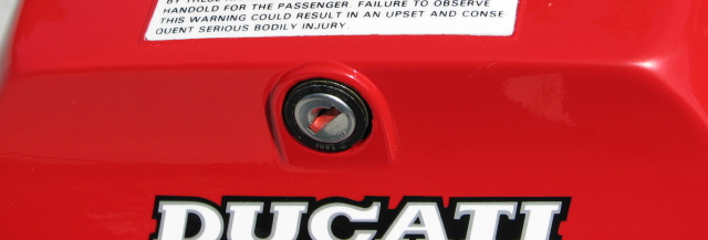

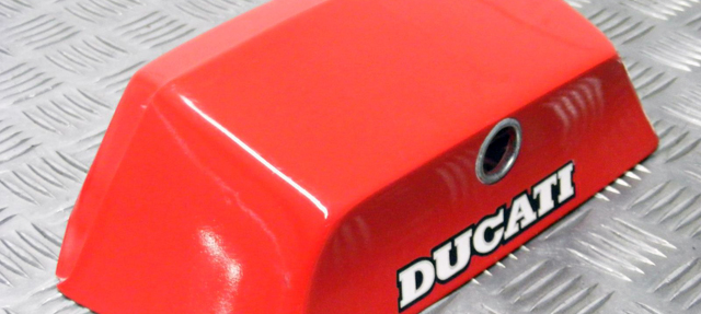

 Post subject: Re: removing key bezel from tail piece
PostPosted: Thu Jul 19, 2018 9:29 am
PostPosted: Thu Jul 19, 2018 12:29 pm
My 907 is the same as the 2nd one, in the bottom picture. The black bezel is part of the lock assembly with nothing attached to the tail piece.
PostPosted: Fri Jul 20, 2018 2:52 am
Posts: 154
Yes their was two types, the 750 had the chrome bezel and my 906's and 907's had the built up area around the key lock. I think that they will all interchange but haven't tried it. Arch.
PostPosted: Sun Jul 29, 2018 8:52 pm
Posts: 30
The top one is the same as fitted to my P750 with a long push rod that goes from the lock into the back of the seat to lock it in place :lol: :shock: The lock fixing and lock mouldings are different so don’t know if they’re interchangeable
