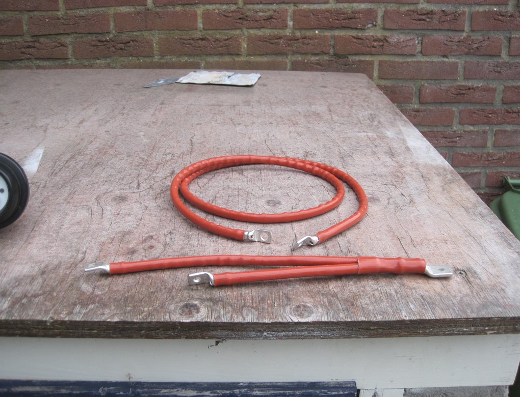

I will mount a new R/R (SH775 if it works ...), a new solenoid, new main fuse, new 16mm2: starter, battery and mass cables.
As a consequence the ignition switch, all handle controls (light, turn indicators) etc. will work with mini Watts, so no overheating of wires and terminals again (I hope ... :lol: ).

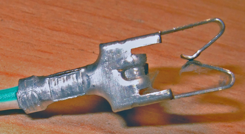

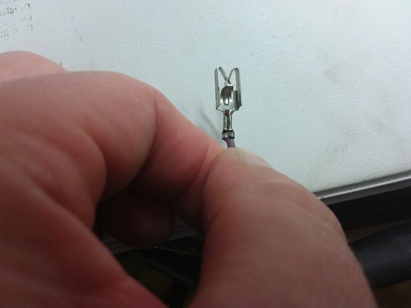

File comment: Dash terminals Paso
File comment: Cables 16 mm2 (5 awg)

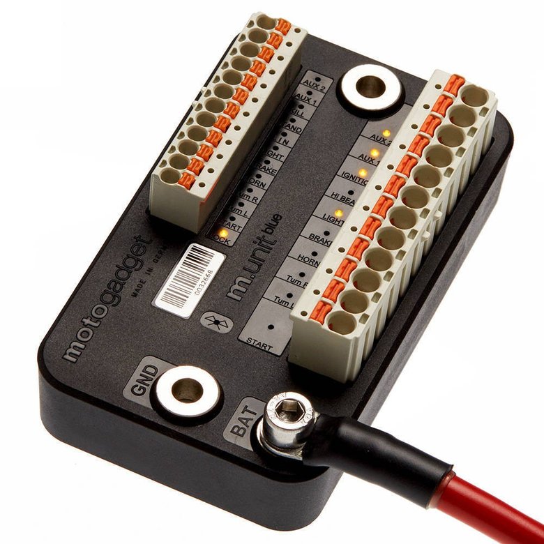

Here's a picture of the Motogadget M-unit " blue", for thosevof you who don't know it.
It's German, very high tech and admittedly a bit overkill for a Paso.
There is also a basic, without bluetooth and roughly $60 cheaper but eith bluetooth it is much easier to configurate (I've used the "old" version: V2 for my Bimota project, and although similar much more difficult to configurate).

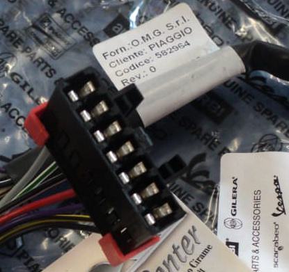

The spring connector looks the same as the ones used on my '86 Vespa T5 instrument panel. So you can check, the overall width of the connectors is about 6,8mm, the width of the contacts 2,6mm and the overall length 21mm. There's a logo on mine but I can't identify it.
Piaggio's supplier of their wiring O.M.G S.r.l..

O.M.G. seems to be a dead end. However those connectors were commonly used on Veglia instruments i.e. on Fiats and Ferraris. Veglia (Borletti) was taken over by Magnetti Marelli.
In an italian Fiat Panda 4x4 forum I found a link to this catalog. Check p.23.
https://app.box.com/s/rtdmucey4aumngggsjqxc8a8vn7x32u5
The company is COPAT in Italy. http://copatconnectors.com/
The bad news is the link is to their 2013 catalog. In their 2018 catalog the connectors are not listed.
If there's an old BOSCH service in your area it might be worth checking if they have something in their old stock.

I did find out that Fiat (eg Panda, 1st generation) and Piaggio (Vespa) did use these terminals.
Also I did check Molex and Copat (imho a Molex copycat :huh: ), but I couldn't find this terminal in their current catalogues.
Since Molex current similar terminal dates from circa 1991 I assume it was original a Molex terminal and it's predecessor (just guessing :-P ).
