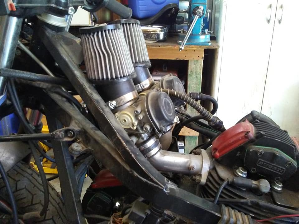

I just did mine, and I am using a small vacuum fuel pump, (3psi), with a return line that t's off just before the carbs. All the info was on the forum.
41801964_2074149295931197_353833755330215936_n.jpg331.jpg [ 76.89 KiB | Viewed 8656 times ]

I'm setting mine up this week, once the carbs are on, you'll need a small vacuum fuel pump, i replaced the screw in my intake manifold with an M5 x 6mm brass fitting, my fuel line comes out of the tank and goes to a fuel filter, then the vacuum fuel pump then to a t or y, one line will go to the carb and the other is a return back to the tank. They also recommend a small bottle for the two vent tubes and the float bowl overflow line also. Once mine is set up, I'll add some pics if you'd like.
