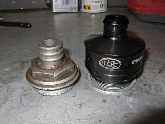

Frank, you're getting lazy :lol: Look at the 906 parts catalogue TAV.32.
https://www.stein-dinse.biz/eliste/elis ... 815g&lg=de
The 906 has a valve before the oil catch container (#20). On the engine the Pasos only have a hose adapter.
The 907IE, the Supersports, Monsters, 851, 888, 916, ST etc have a higher engine breather/hose adapter instead. There's a membrane inside.

So if I understood well I could buy one of those fancy aluminium ones you see on ebay (CNC, etc.) and it would fit on my 750 engine?! :thumbup:
Any idea if the outside diameter, where the hose fits, is similar to the 750 version (meaning: the hose fits breather tank aswell as the mentioned later adapters)?

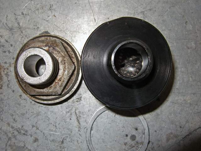

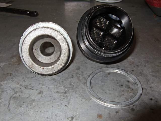

 Post subject: Re: 906 airfilter box - crankcase ventilation membrane
PostPosted: Thu Oct 04, 2018 11:22 am

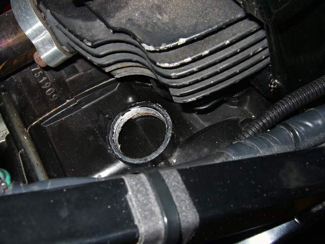

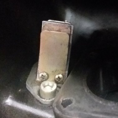

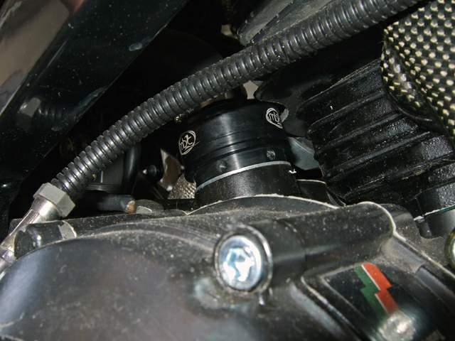

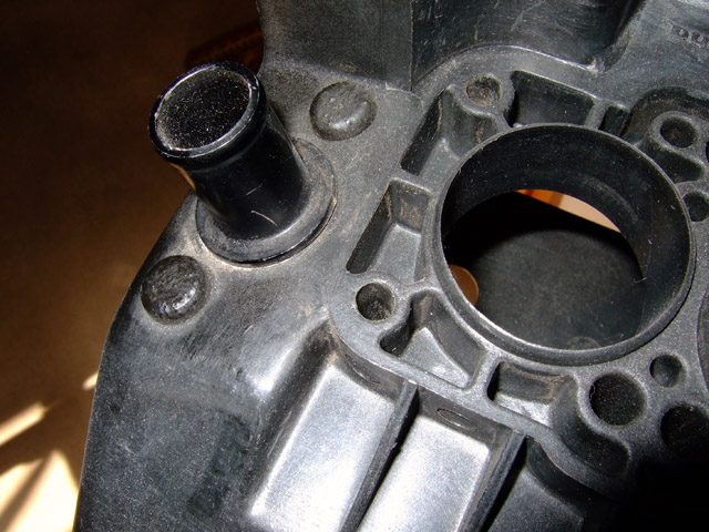

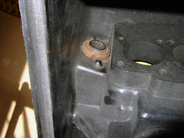

PostPosted: Thu Oct 04, 2018 11:33 am

Got another air filter box from Rudy since I was looking for the hose nipple that I was missing.
To my surprise this 906? air filter box has a membrane in it .... didn't see that on the 906 parts list. :shock:
And although provided with the same part number it is actually a little different to the other 906 air filter box.
There is and old sticker with italian on it so I assume it's been used in Europe, but again I didn't know it existed.

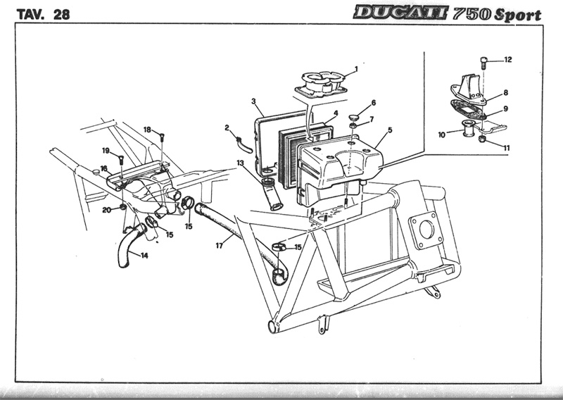

PostPosted: Fri Oct 12, 2018 5:10 pm
What Rudy sent you is the airbox of a 750 Sport which indeed has the same part number as the one of the 906 but is and looks a bit different.
