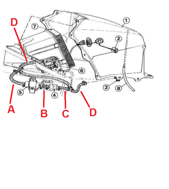

So Jed, just so I'll be sure I'll understand:
In the attached Drawing, in which letter you added the 4mm pipe?
Where you put the pressure gauge?
I presume the question are due to bad English understanding, THANKS.

That's the wrong picture. The setup with the loop was used in case the tank had no fuel return connection. However also that setup used a Dell Orto jet (size 60). The jet is positioned in the second (left) Y piece in the exit that goes into the loop (or to the tank's fuel return connection). That restriction is not to reduce fuel pressure but to make sure that the fuel return to the tank does not cause the pressure to drop too much.

as already said the diagram is not quite correct but using your diagram the restriction/jet would be in the pipe between the Y piece on the left and the Y piece on the right between the 2 D pipes the pressure gauge would be placed in the end of the pipe D after diconecting it from the webber which should read 3 psi with the pump running :lol:
