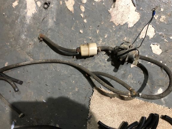

Hi Folks. I stripped out the fuel lines on my Paso 750, and started replacing the fuel lines with new pipe. Only to find the fuel filter connections cracked. Took me a couple of weeks to getting the replacement by which time I had forgotten how they went together (yes I know I should have taken pictures). Anyone got a few pictures of the pipe connection arrangements and the location of the filter in place? Sorry for asking for daft information. I usually work better than this. any help appreciated. Cheers :banghead:

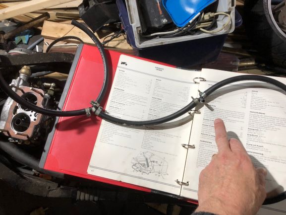

Hi Paso750. Many thanks for the info. My fuel line also has a T piece in it. Also, I would like to know if the fuel filter runs on the inside of the fram or the outside? Please see attached pictures. One of a complete line set from a Paso I just stripped, the other showing the new lines I made up with the T piece. Any advice appreciated.

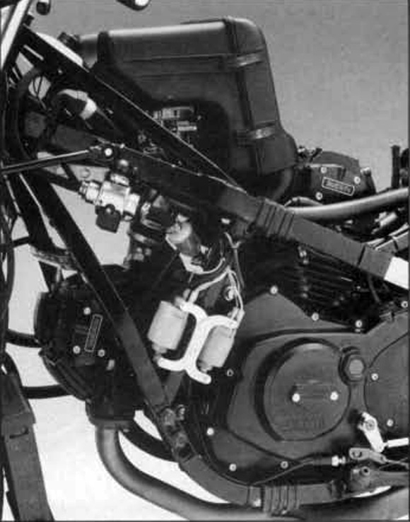

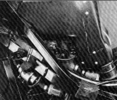

The reason you can't upload pictures may be that they are too big.
Here two pictures taken from old magazine articles.

Hi 750 Paso. That is great. I can now see which location the filter runs. Any idea on the T?

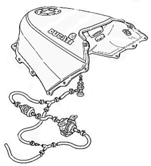

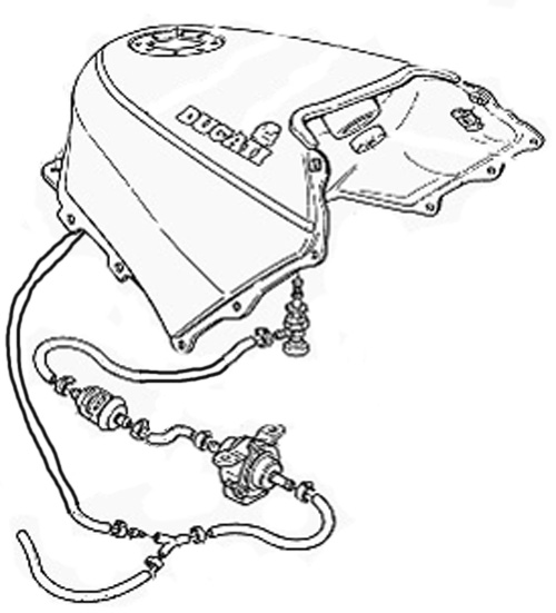

The position of the T makes no sense to me.
There are 2 possible fuel line setups. The first one below is the one you have in your first picture. That is if your tank has a fuel return connection.
The second is if the tank has no fuel return connection. Then the fuel is sent into a loop instead to reduce pressure.
Note that in the Y-piece there's a Dell Orto jet as reduction piece. As in the pictures that should be in the exit to the tank/loop. Btw the fuel petcock shows forward not to the right side as shown in the drawings.

That is really appreciated. Many thanks for solving this problem. My bike is a very early one, so the return pipe is probably the issue. Cheers 750Paso :beer:
