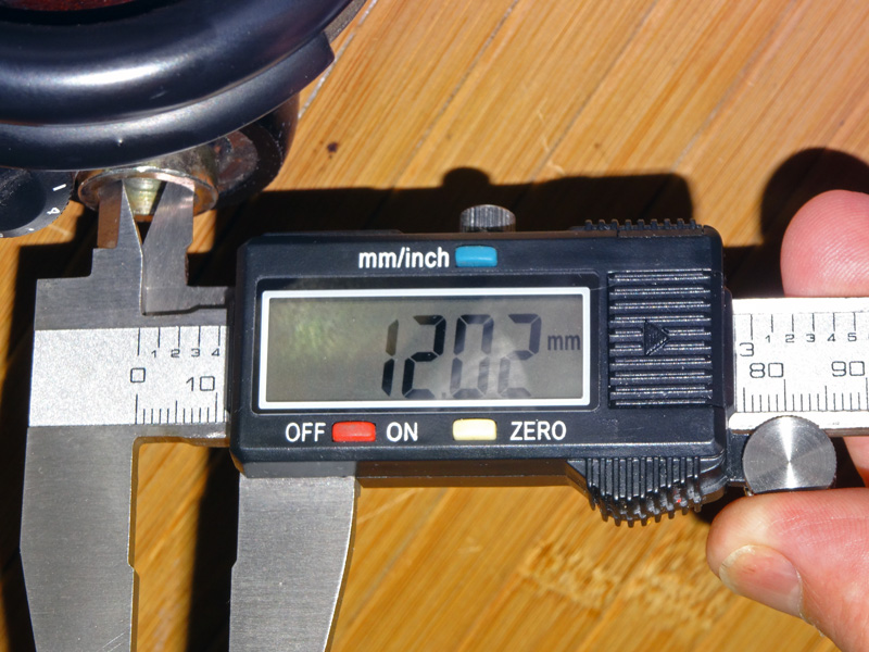

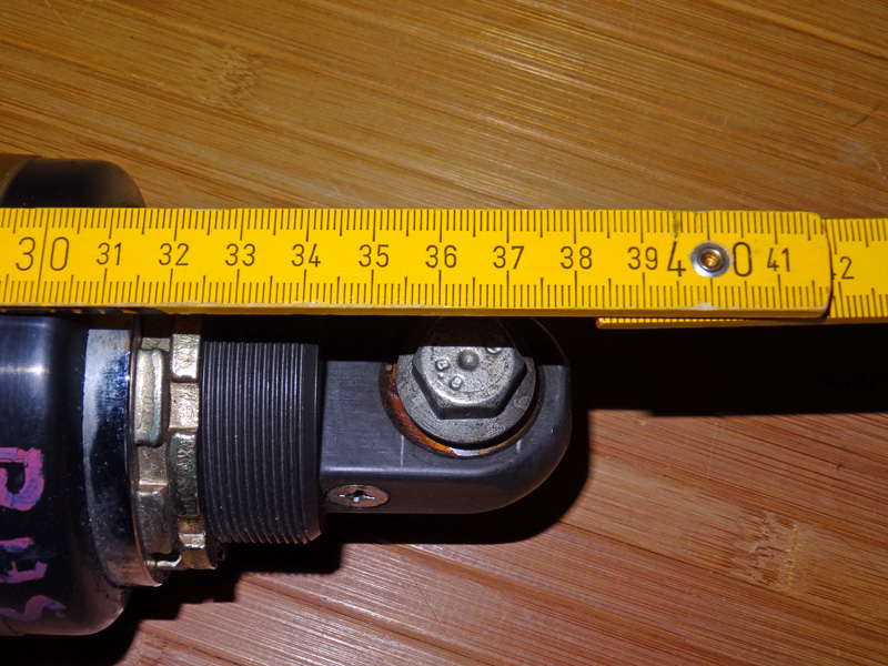

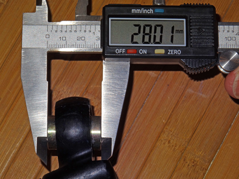

the dimensions

Hi
Once again, super helpful.
Alistair

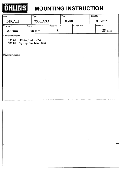

Hi Alistair,
Maybe this is also interesting for you: the 'technical data sheet' of the Öhlins DU508 shock absorber which was installed on the first 950 or so 750 Paso's. The form is named 'Mounting instruction', but there are no instructions on it whatsoever :) Nevertheless, there are some sizes on it.

Ronald
Thank you! It confirms the length.

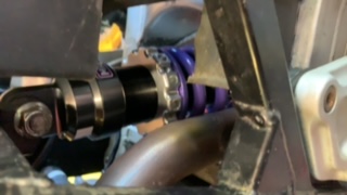

New shock...
