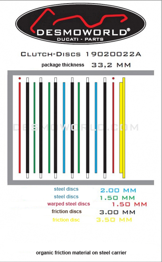

Usually I stay away from clutch disc order discussions as imho there’s no ‘right’ order as long as the spring disc goes in first and the onesided friction disc is last. Where the second spring disc sits and if it’s reversed or not has no impact on the stack height or the function of the clutch. (My opinion)
I never understood the Surflex catalog for multiple reasons. If you compare the parts numbers in the P750 and 750S parts catalog from clutch basket, core, discs to springs all parts on both have identical part numbers. However the 750 Sport parts catalog mentions 2 steel disc thicknesses. There’re part numbers for 1,5 and 2mm steel discs but the 2mm has no number and does not appear in the exploded parts overview.
The 750S parts catalog lists #19020021A for the complete clutch disc pack, there’s nothing mentioned for the P750. If you check Stein Dinse you find that #19020021A (and 066516690) has become #19020022A which is supposed to fit not only the Sport and Paso but also the 907IE (which seems odd but that’s a different story).
Still Surflex lists different clutch kits. For the Sport only the sintered S 1448 and for the Paso the organic compound S 2076 and the sintered S 1686. (based on the catalogs available on their website)
In the past I’ve bought original car parts from an Audi dealership that had a completely revised design so I can accept that for the P750 there’s a clutch kit with a different setup than what came from factory.
This is the first time I see the S1448 kit listed also for the P750. I find it interesting that now the Sport isn’t listed anymore. Makes you wonder which kit is now the ‘correct’ one for it.
The two pictures posted above don’t match. In the technical drawing the spring discs are on each end of the pack. In the picture above it the second disc is in the middle which is actually the same as shown in the P750 parts catalog. The picture on the bottom of this post shows the S 1448 in reversed order while pictures of other clutch sets are correct… :truck: Surflex's info is not very consistent.
As for the 1,5 and 2mm steel discs in the ADIGE kit I agree that this is probably just a cost measure, a kind of modular system to realize different stack heights by combining them.
Several years ago I had posted this picture regarding the #19020022A clutch kit. It’s probably what you had been looking for.
download/file.php?mode=view&id=665
