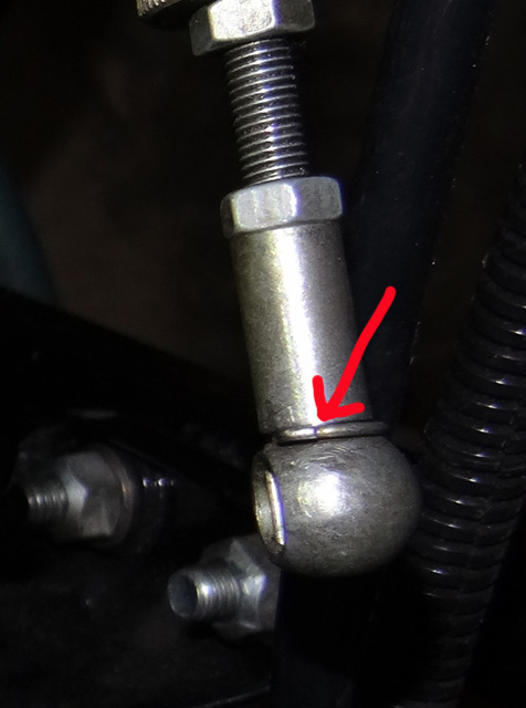

don't just pop it off. Remove the clip first.
 Post subject: Re: Carb rebuild + throttle linkage
PostPosted: Tue Sep 01, 2020 6:06 pm
+1 remove the clip first
PostPosted: Wed Sep 02, 2020 7:32 am
Wot firetruckin clip !? Mine dont got no clip ,just sorta sits there :lol:

I didn't pop it off bks it didn't feel right. Thanks for the heads up on the clip.
