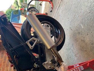

BOS pipes going on...

:D ha ha , I was just thinkin ,lightweight free flowin pipes are a surefire way of reducing lap time (the last thing you wanna do at a strip show ) but the fact your racing a Paso in the 1st place suggests your not interested in winning :lol: . Did you keep the mirrors on
? They'd be dead handy for spotting the rest of the pack comming up to lap you.....again :P :lol:
Seriously tho , I guy I know who races air cooled belt drives reckons the best start to get a bit more Ned is to fit larger headers, so I dunno if the 904cc headers are bigger than the 750. Have a look at a few pix of racebikes and see if you can't spot a nice looking 2 into1 to copy. They ain't that hard to make if you can work a hacksaw and a welder. And don't be in to much of a hurry to ditch the weber, it might be a bit cranky at low throttle openings/speed but there ain't nothing wrong with mid/ top end performance. :)

Larger headers are available from Europe. The diameter is bigger on models sold there.
