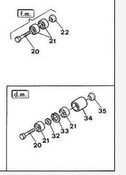

I'm guessing you have the bottom belt idler. There's a circlip in the middle (#33).

not sure how to get them out with the circlip between them

Looking at the parts diagram, it would appear to show two different idler bearings schemes; one with the bearings in a sleeve (d.m.) and one with the bearings exposed (f.m.) Drawings in the factory repair manual (F.4) appear to show idlers without a sleeve. The part number for the bearings in both schemes is the same, sleeve or no sleeve, but the spacer has a different part number, depending upon which setup you're using. Both appear to be discontinued. I wonder if the only difference is the thickness of the spacer to make up for no clip between the two bearings?

on the first pages of the parts catalog it says:
F.m.: up to frame number ...
D.m.: from frame number ...
No idea what the frame number is. Can't find that info.
Removing the second bearing from the sleeve should be easy as soon as one is out.

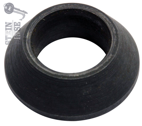

This is a pic of the spacer used on the belt idler w/o sleeve. (#22) Couldn't find one of yours.
