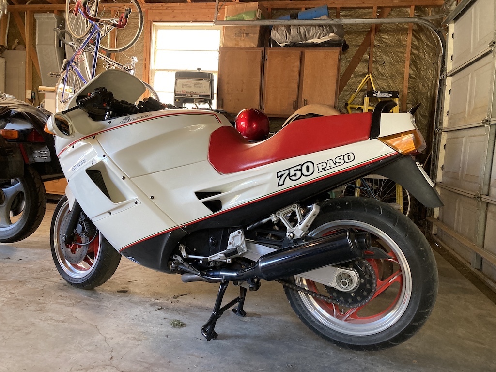

Finally, after a year and several months since acquisition, I got to ride my new to me 1988 Paso. When I acquired it last year it hadn't been ridden since 2003. I bought it because it was very complete and showing only 7,028 miles.And it was white with a red seat, the color combo I wanted. I installed new timing belts, checked valve lash, replaced front and rear brake masters, flushed all the hydraulics, replaced rear wheel bearings (fronts were fine), new tires, new mufflers, rebuilt the forks, replaced the rear tail light assembly with a Euro unit for the benefit of encased turn signals, cleaned up a few niggling electrical issues and installed a relay for the ignition to ensure 12 volts at all times, and attempted to rebuild and install the original Weber. That last bit didn't produce any fruit, despite my best attempts. It's back running the TM38 Mikuni flat slides it came with, which not surprisingly work perfectly. First ride was a shortish 45-mile jaunt through the surrounding countryside. Never got over 60mph for the simple reason I wanted to become familiar with the bike's sounds. In my experience it takes a little time with a new-old machine to learn which noises are worrisome and which are normal. And it does make one odd noise, a sort of light knocking sound just off idle - you almost have to coax it with light throttle, but it's high up, not deep in the engine, and I think not in the engine at all. It almost sounds like one of the carburetor slides lightly rapping in the carb.
So far, that's the only head scratcher. It starts and runs brilliantly, and it handles beautifully, although admittedly I've yet to even remotely push it. Brakes are excellent despite still wearing at least 20-year-old shoes. Took a few miles for the rotors to clean off, and they look good. I've wanted a Paso since seeing my first in the flesh back in 1988. Hoping for some good miles in the near future. Link goes to a pretty poor video of the bike being started. It doesn't sound particularly sexy, but hey, it's running Silentiums.

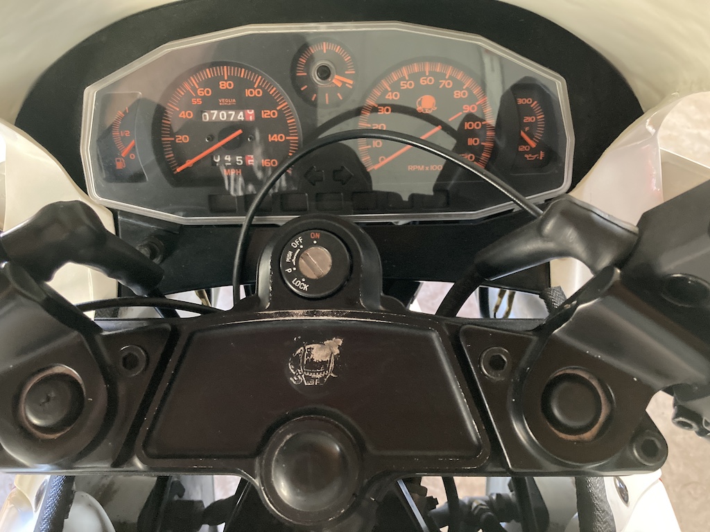

OK, I'm dumb; attachments are easy. Couple pics for fun. I'm loving this bike.
