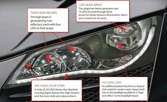

Derek, there was a misunderstanding. Of course LED lights from original manufacturers are legal as LEDs, reflectors and lenses were designed and engineered to work together at best performance and then the whole light is tested and officially approved.
It`s a different story if you put LED bulbs from China in your lights which were made for filament lamps.
Light range, scattering angle & light dispersion will not be the same which is why doing this in Germany and also the UK is not legal. Don`t know about the US or other countries.
Just look how complex an Audi R8 headlight is
