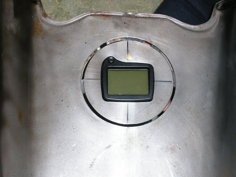

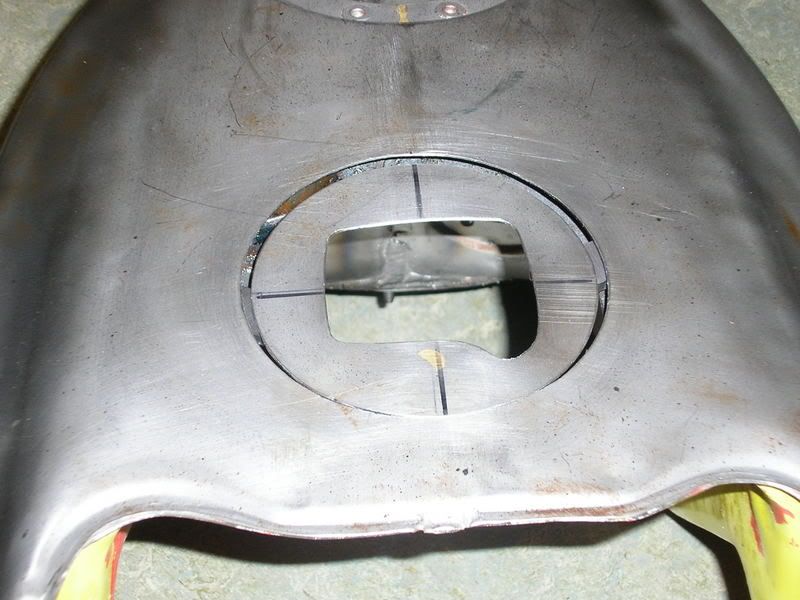

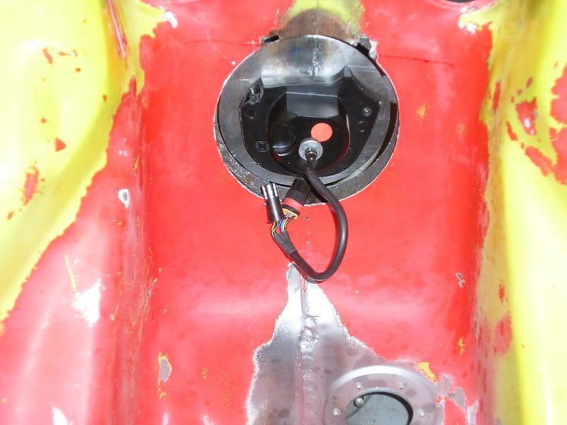

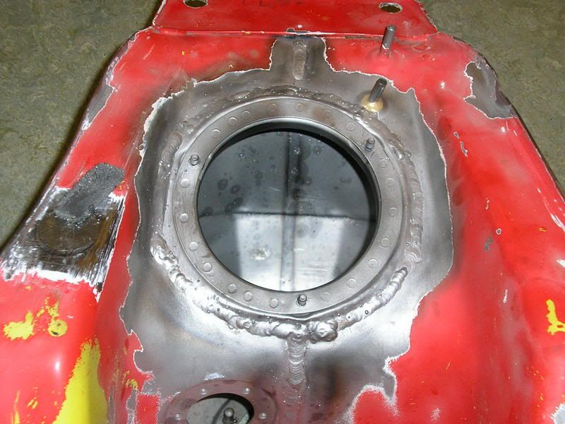

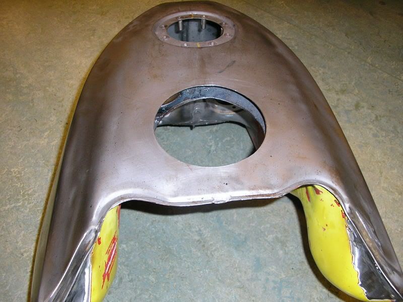

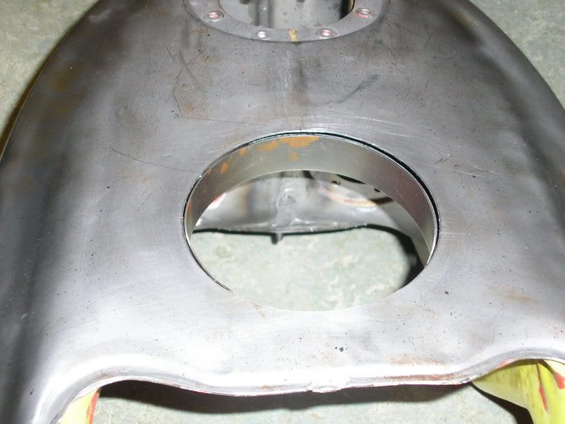

I have modified the fuel tank.
So now the tank will fit the ST2 fuel pump unit.
I also make the ST2 fuel meter on top of the tank.
See the photo's:
Hole for ST2 fuel pump unit

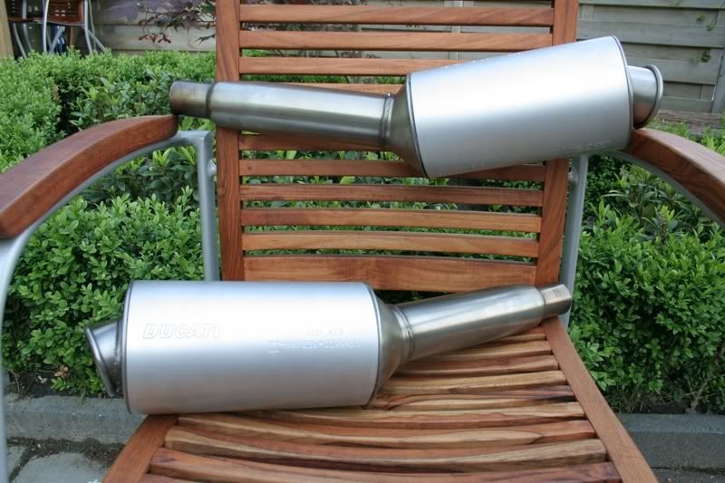

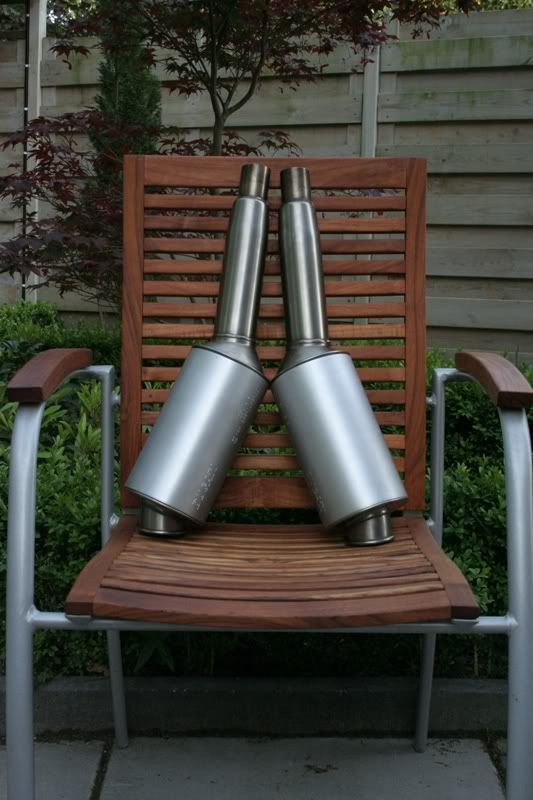

Good job for mufflers! I taught, from ST2... :thumbup:

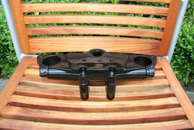

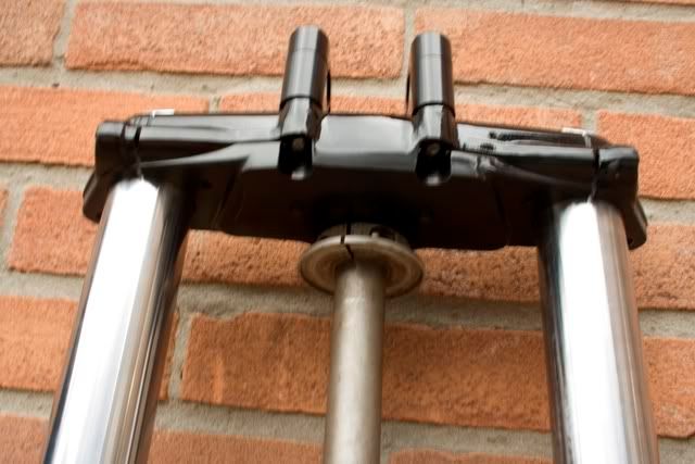

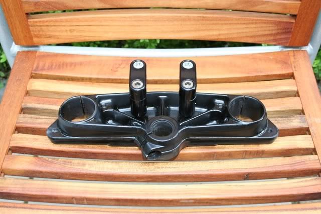

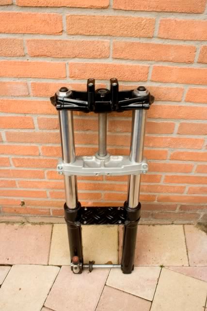

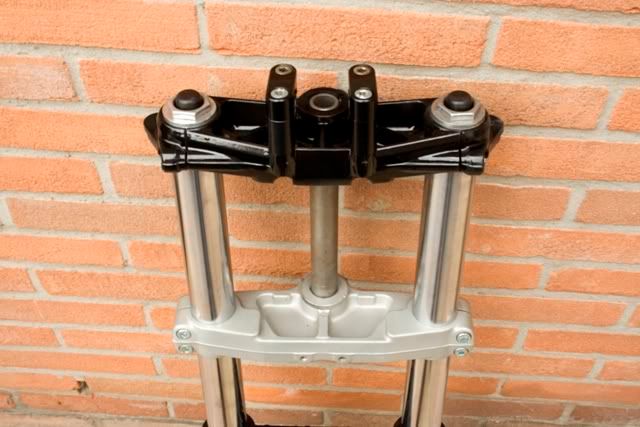

I have made an new top yoke for the Paso.
It is actualy the original top yoke upsidedown.

Here you can see the top yoke beter.
Now the botum side of the top yoke, is the top.
It is now an up side down yoke.

So, You used those key lock threads for connecting steering bar... :evil: Good job again! :thumbup:
