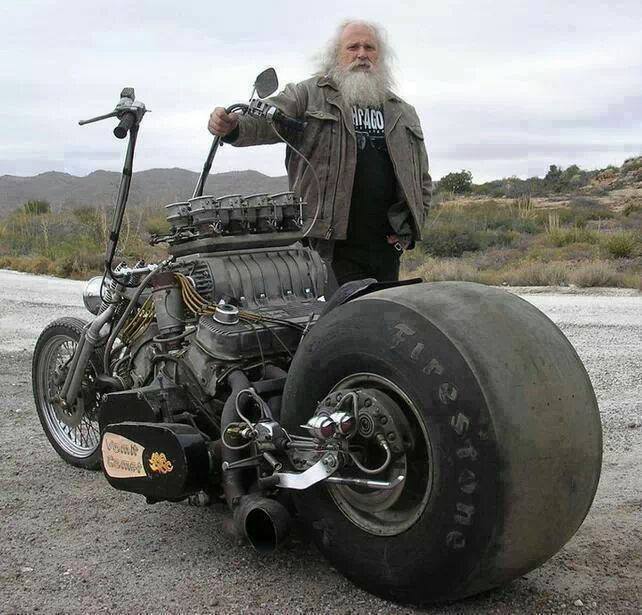

Holy crap G ! you sure don't look like what I expected :) er, nice bike :roll:
