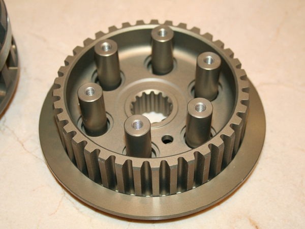

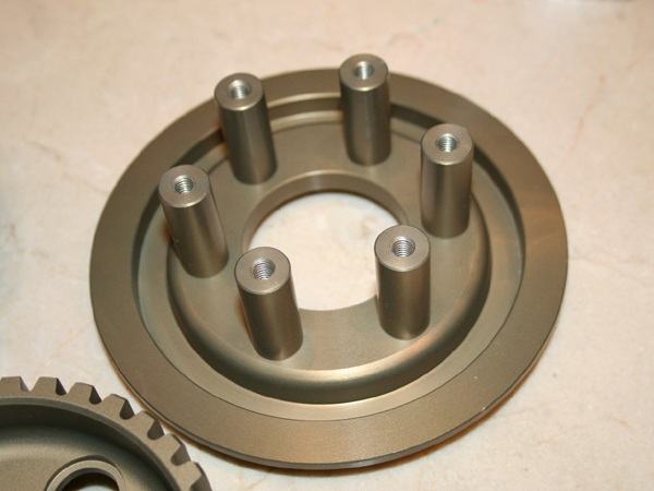

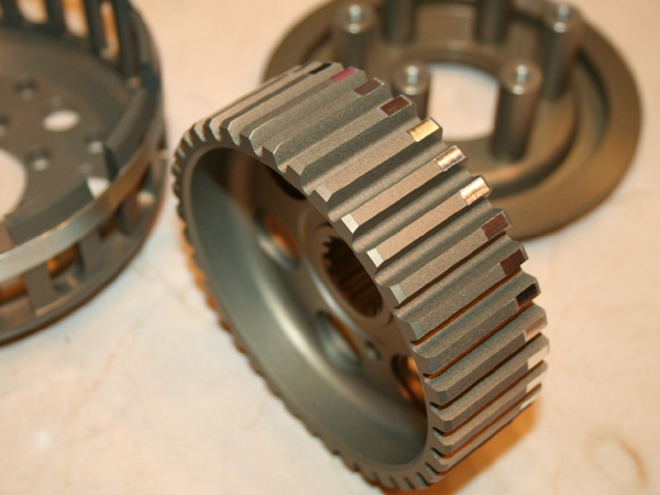

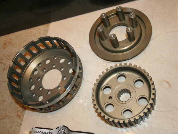

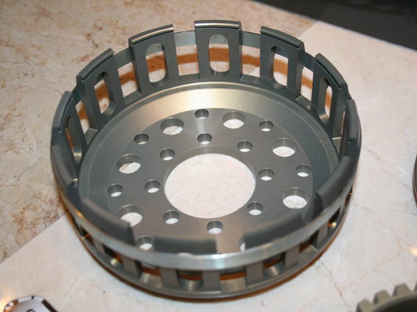

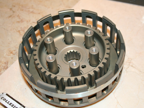

found some more pics of those race parts on a japanese website. They are nice.
