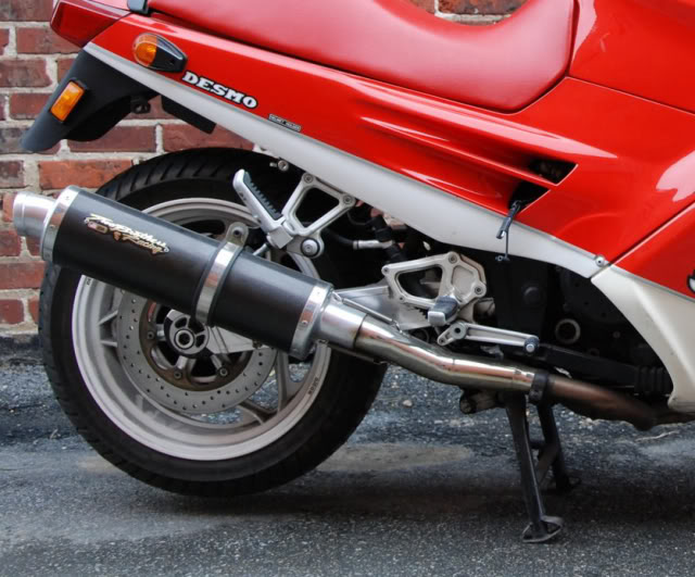

But that`s me. I personally find it more difficult to start off with something already modifyed (in this case a Mikuni with a pilot jet from a 750, the needle jet from a 900 and an unknown aftermarket needle). Of course you would need a leaner jetting for the altitude you`re living at but on the other side you don`t have an airbox, but you`re using UNI pod filters and have (what seems to be) a Two Brothers exhaust which will make carburation leaner. The effect of the altitude could be equalized by filters and exhaust or maybe their effect is stronger than the thin air.

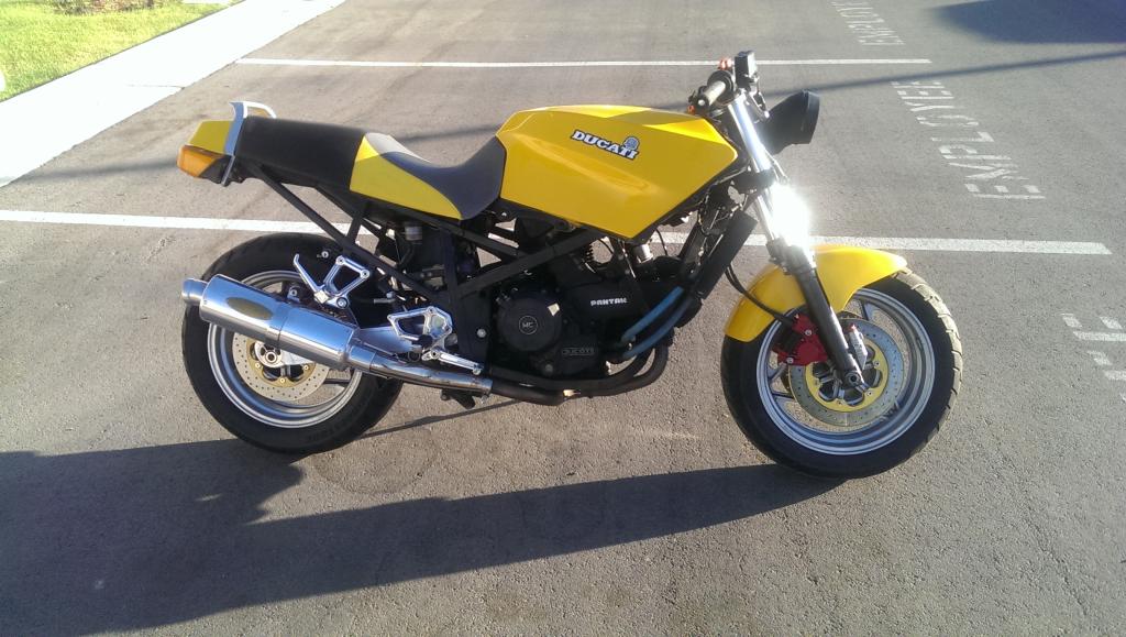

I am not sure on the exhaust brand, I have looked at it but can't remember.. it seems to be running good, still not idling as well as I would like.. I still have symptoms of a vacuum leak but there is none..
When it is warmed up completely the idle will hang about 1000 rpms higher but I can't find the middle ground. It's either to lean or to rich

if the idle is high, you can`t lower it and you`ve verified there are no airleaks I`d say the carb is running lean. Noone else have an opinion ? :)
