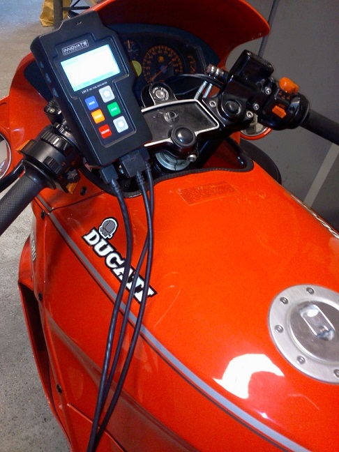

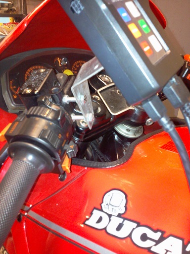

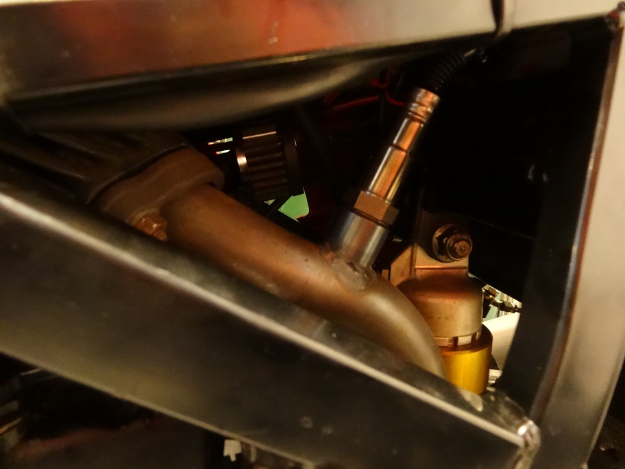

Ok, it has been a while. Last couple of weeks I'd another go at the setting of the Weber. This time I'm going for a more 'scientific' approach.. ;) First thing is to get all the LM2 stuff installed to get an idea of the current airfuelratio. I've welded the dung on the vertical header for an easy installation of the O2-sensor. Did I mentioned I've put on new NGK spark plug wires earlier? These red sillicone ones don't work well with the LM2 clamp.. :banghead: After ordering and installing the analog-cable (black/white wire on negative position coil) it works fine for a stable readout of RPM.
