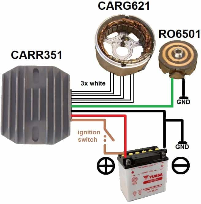

OW, small update, my regulator/rectifier died today, ive got 15,8 volts at the battery. Battery didnt liked that. Now bought a used one from a Yamaha fz600. ITS a 7 pins, so i have to gave it a thought. Colors on it are 3x white. 1 red 1 black 1 Brown 1 green. 3 white is generator. 1 green is stator 1 red is battery 1 green is ground 1 Brown is lights and stuff. If im wrong please let me know. Dont want to ruin this regulator. Part nummer is SH233A-12

imo that three phase Yamaha regulator won`t work
https://www.carmo.nl/images/Yamaha_XS65 ... _rotor.jpg

Ive seen the picture. Do i have to use all the wires to use the rectifier? I thought that it wasnt needed?

wrong type of regulator, excited field regulators I don't think will work either, Could be wrong, on this type of regulator the battery also provides the magnetic field. Never thought to try but chances are the battery can't provide the current to make it work as intended
get one of these and never look back :beer:

So, what kind of connections do i need to make a rectifier work on a ducati paso? It is the old model paso 750. 3 x dynamo. 1 12 volt? 1 ground? 1 for lights and stuff?
