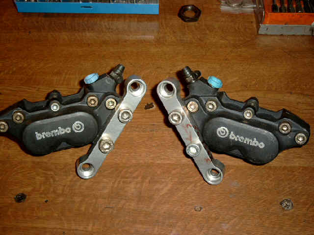

Here`s the drawing. It cost me todays rainy afternoon and as I have a bad headache now I didn`t doublecheck everything but I think it should be ok. (the .ppt file is better printable)
http://www.box.net/shared/tnyfou50ck
PS: the picture above shows the adapters mounted incorrectly btw. What the adapters mainly do is shifting the caliper backwards to make it fit on discs with a bigger radius.

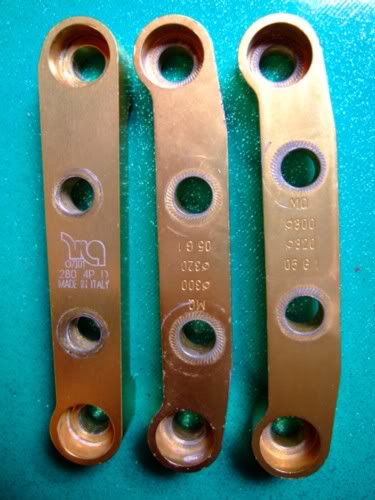

the adapters fit with both 300 and 320mm discs. It just depends which way round you mount them.
Here a pic of my 280mm adapter (left) and the 300/320mm adapters.
As the mounting holes for the caliper are not centered, the caliper will be in a different position depending on if you put the adapter on the left or right side of the fork.

Currently i have just same adopters, as You(those in left). I use them with normal 750 Paso M1R fork with 907IE black calipers and normal 750 Paso rotors.
Seems, that now i have found, what i was looking for..... :thumbup: :thumbup: :thumbup: :thumbup:
I REALLY apperiate You, Gerhard, how much You have time to do all that work with computer :thumbup: :thumbup: :thumbup: I downloaded already measurements to laptop, so seems, that i give them close times to my friend, "lathe man"... VERY good drawings, so very many thanks to you, Gerhard.... :thumbup: Hopefully we meet one day and then i buy dinner to you.... :thumbup:
Btw, i noticed from You last foto, that there is stamped both 300 and 320 !!!!
