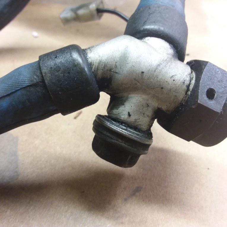

Not the best picture, hope it is what you need ...
Otherwise let us know why you need it
File comment: Oil temp - paso 750

Hi Marco,
Here you have the actual oil temp. sensor (M10x1 mm. - similar thread to a Brembo banjo bolt).
A new one costs 16 euro.

The thermistor is the same as the Volkswagen Golf MkII
