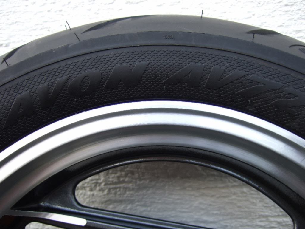

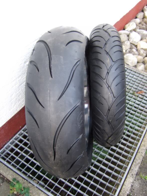

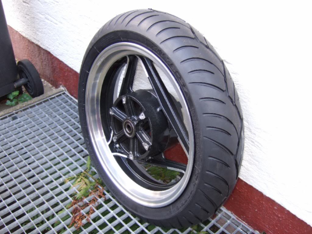

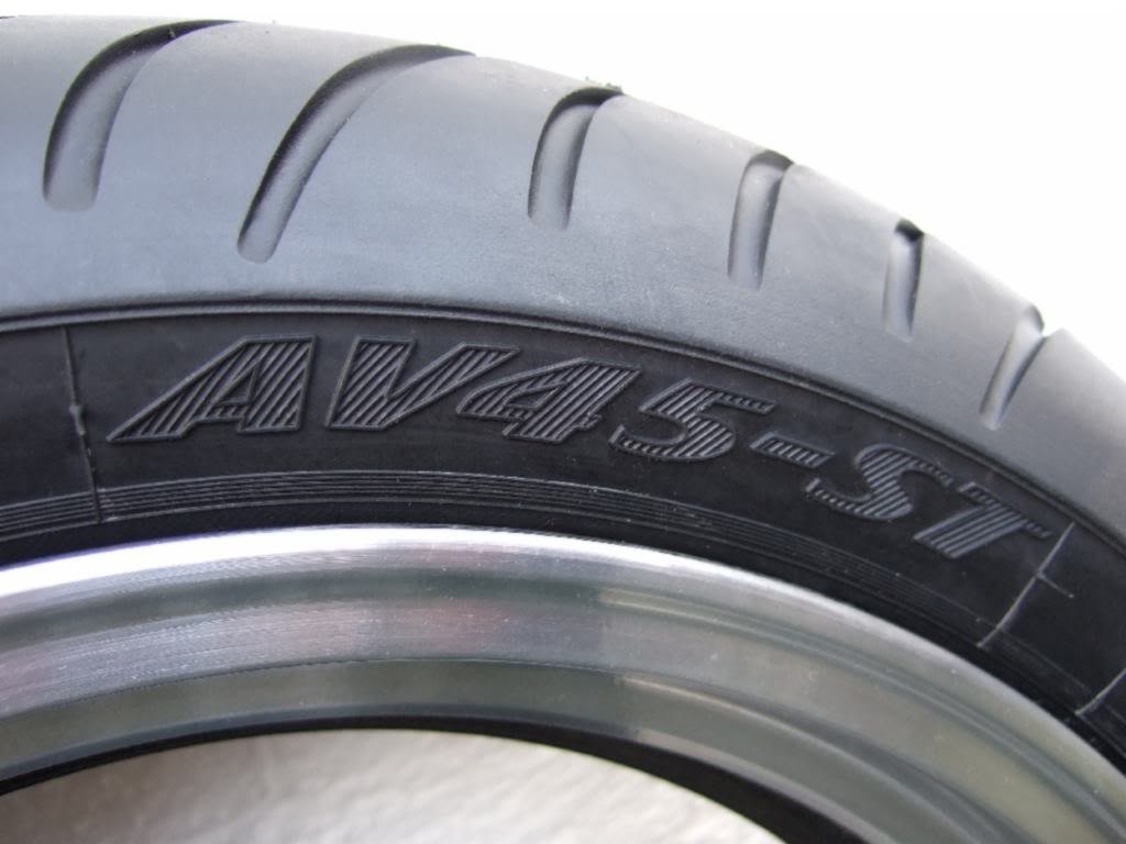

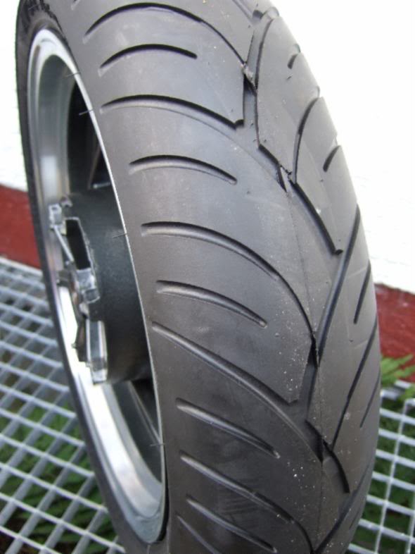

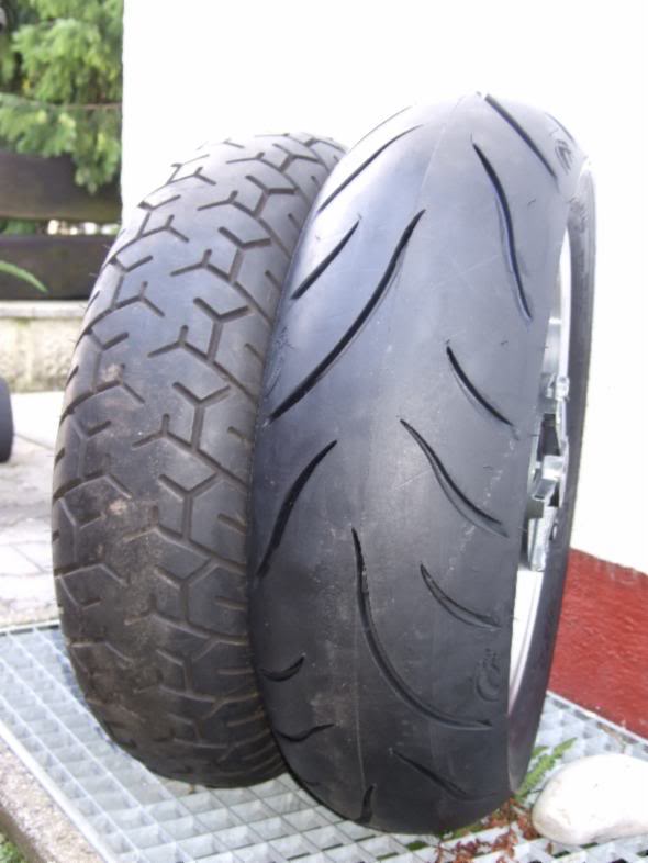

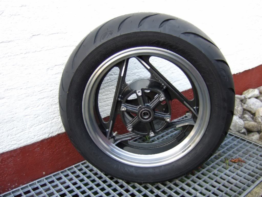

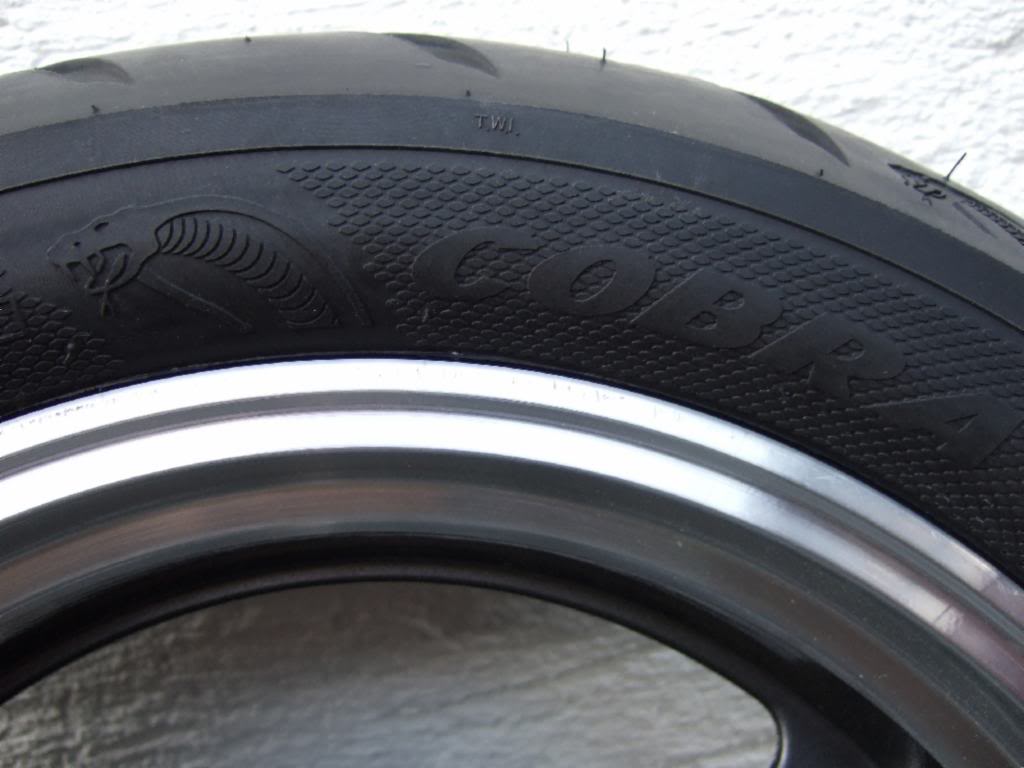

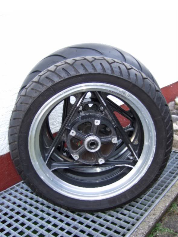

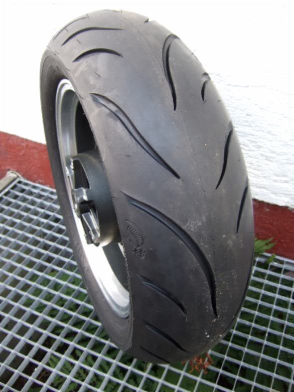

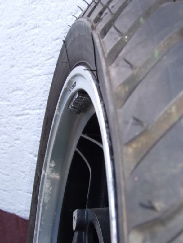

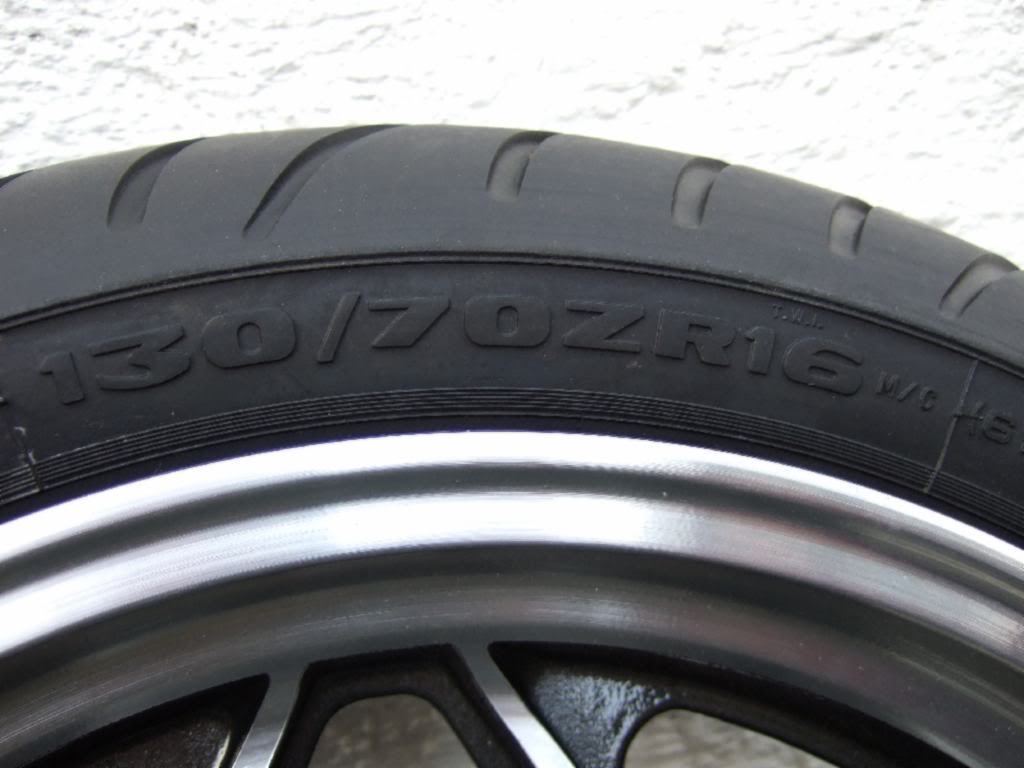

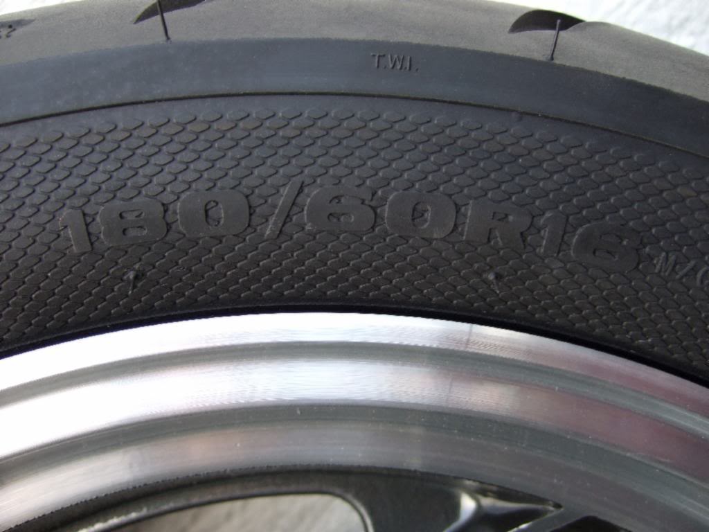

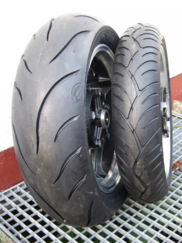

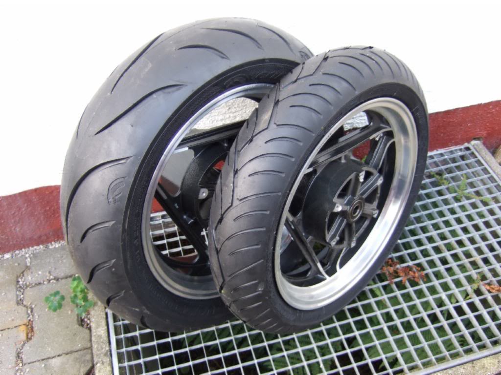

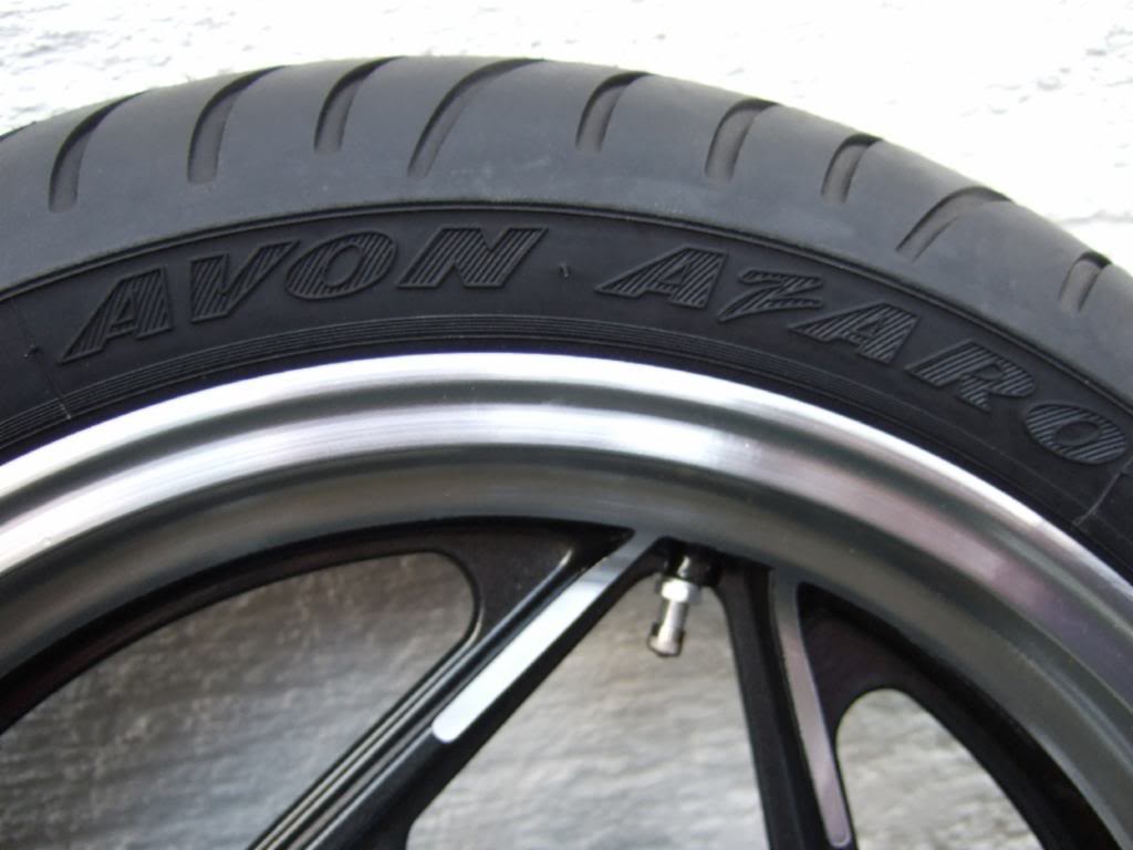

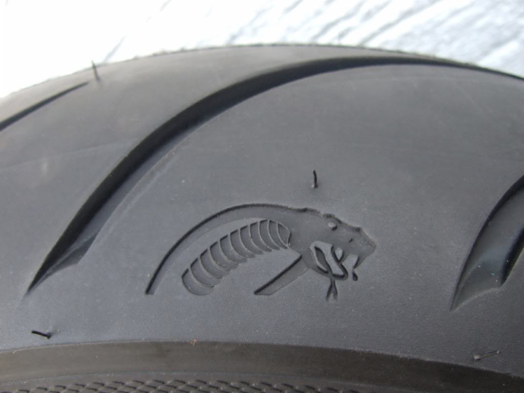

As I was writing already 2 or 3 years ago that my next set would be Avons I finally got mine, too.
Paid €98 for the front AV45, €130 for the rear AV72 (mounting was €34 - grrr). (german webshop: http://www.mynetmoto.com ) Listprice of the rear tire is €219 according to the tire shop where I got them mounted on the rims. They sell it for €148,- which proves that there are huge price differences with Avon tires and that checking numerous shops really pays off.
Production date of my new set is cw19 and cw21/2009.

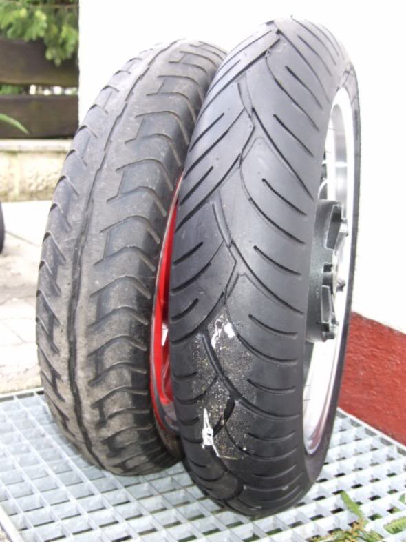

Front and rear tire are quite a bit different compared to the old ones. The front tire is a bit higher and rounder shaped, the rear is quite a bit taller and wider than the old one. All in all that should affect handling positively.

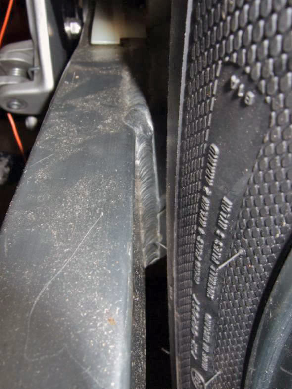

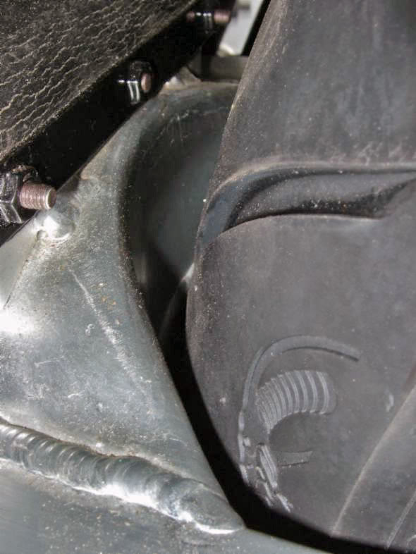

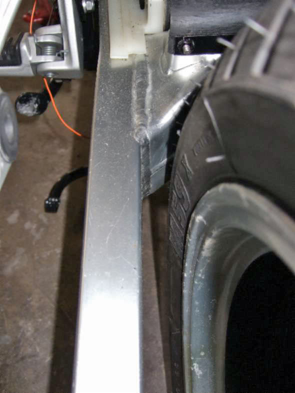

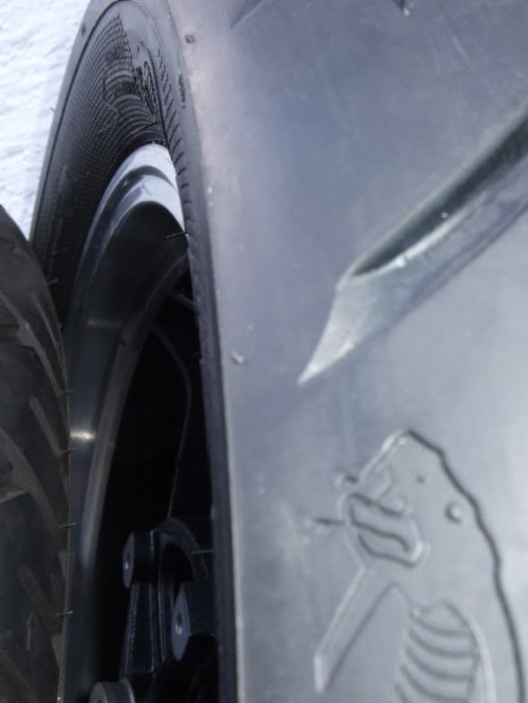

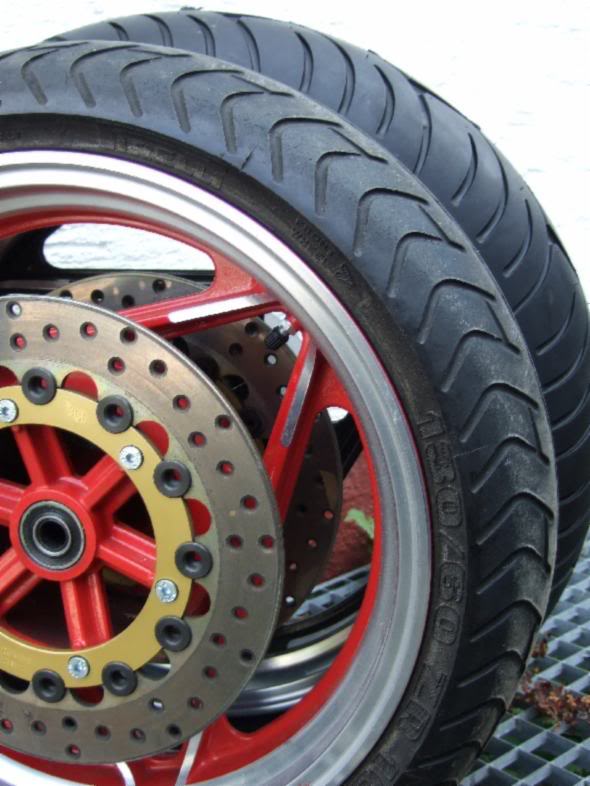

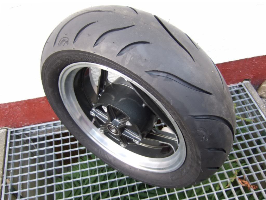

I put them on the bike this morning so here`re some pics. Clearance of the rear tire is about 10mm to side and front with the excentric adjuster in middle position.
I didn`t do anything with the chain yet, as I have to finish some other things first, but I`ll post my solution when it`s done.
The main general issue I see is that the stands are too short. The center stand only touches the floor with one leg so I will put on one of a 907ie this afternoon. The side stand is also too short and as a consequence the bike leans over too much. Update: the 907ie centerstand works just fine as it is a little longer. The bike stands with both wheels touching the ground, but it stands stable.

Great fotos and good details!
I have been also thinking "only" this combination to my 750 Paso. Let us know, how much chain hits to side of rear tire, or do it so at all... Are you planning to change chain line offset?
