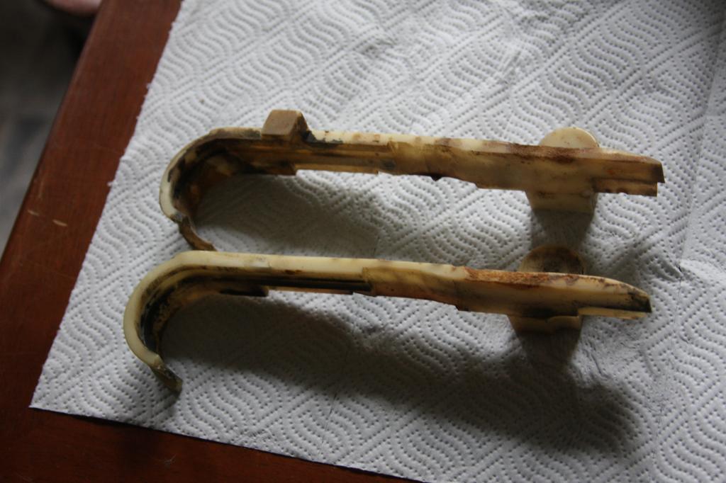

Looks to me like all 3 sliders are basically the same. Relief contours and the shape of both ends may be slightly different and the 906/750 slider has the extra tab but that's of no consequence to the way it fits the 907 as it can be cut off or just left on.
Looks to me like we have a one size fits all situation :thumbup:
750/906 on top
907ie on the bottom
btw the reliefs appear to be hand cut in every chain guard I have(4)

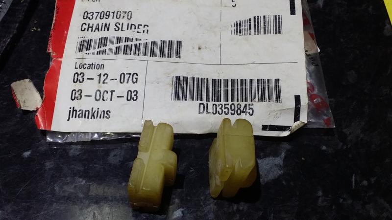

I am happy to post these to whom ever needs to make an exact copy if and only if I am assured of their immediate and safe return.

no need see p.3&4

Sorry G while reviewing the thread I missed out on the fact that small one's fitted perfect. Forgot I had these little gems and found them yesterday while clearing some space in the Garage. :dunno:
