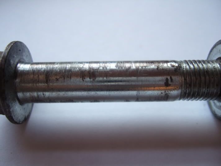

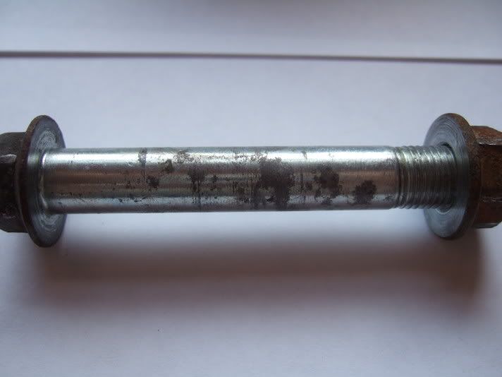

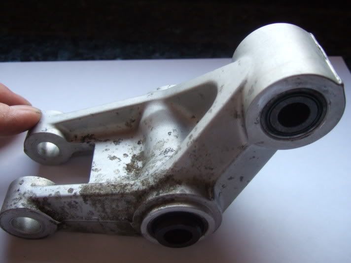

If you mean this part, then yes the same happened to my bike at 19000miles.
Was offered a good used part for £70! in the end just knocked the bearings out and replaced them.
All the wear I found in the bolts and in the bearings.
The bearings are stardard off the shelf items so your local bearing supplier should have them.
The only items i could not get are the spacers.
You can see the wear hear
