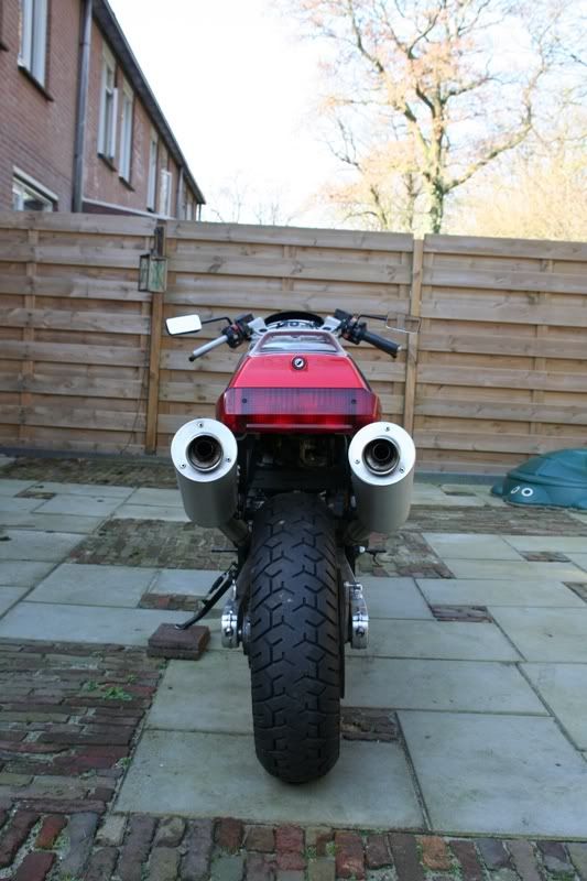

Hallo,
I am now bilding up the bike to fit al parts.
Here are some pictures.

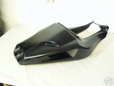

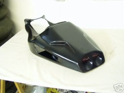

I also have bought and 916 rear/seat.
The two exhoust pipes are going unter the seat of the 916.
Greetings,
Karel.
Something like this!
This is nice.
 Post subject:
PostPosted: Sun Mar 11, 2007 8:27 pm
Posts: 3081
Location: Finland
????? in that 2.foto: How U route those pipes, cause i cant see front headers at all ??? :confused: Are those pipes from ST series?, if so, then they are too heavy to streetfighter... :funny:

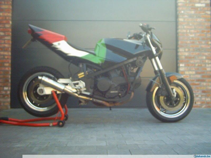

OOOO my G..!!!!!
:sad: :sad: :sad: :sad:
This is not my kind off streetfighter!!!
I like more like this:

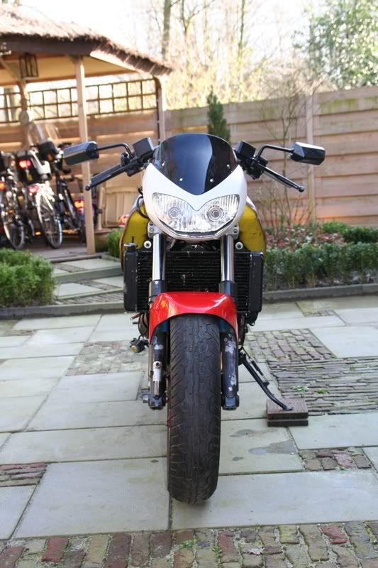

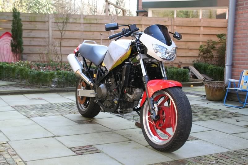

I use the hole wiring/injection/coils, etc... systems from ST2 with M16 ECU.
ST2 engine have exact same mounting holes as the 750 engine.
The engine is only wider.
The radiator is from an 907i.
May be I will use later an curved radiator.
 Post subject:
PostPosted: Wed Apr 11, 2007 2:32 pm
Posts: 3081
Location: Finland
I dont know, what fork/wheel/tire U are going to use, but if M1R, then U have to be carefull with distance between front tire and front sylinder head and radiator. Problems can come, when M1R fork goes very deep down in hard braking.
ST2 engine is just as wide, as 907IE engine. But, if U make "naked bike", then no need to be worried about wide of engine.
If U use 750 frame and add radiator, surely then need to make some welding job to make "connectors" for radiator to Paso frame. I think, ST radiator needs different mountings, than 907 radiator... :evil: I give advise: If possible, go direct to curved ST radiator! :thumbup:
Let me know, how U "go on" with Your bike, cause i have some quite "close plannings". I look opinions to fit "some injected engine" to my 750 Paso and i have one spare 907IE engine(i have some other spare engines also waiting right time/frame... :evil: ) for that already, but ST2 engine is also very good opinion....
