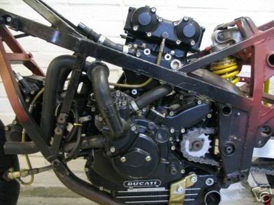

here the pics of the frame that was on ebay longer time ago
There`s a german guy with a 907ie with a ST3 engine.
If you can drive a car in the US that has the shape of a shoe I`m sure this will be street legal also :mrgreen:
Wouldn`t it be easier to use your 907ie swingarm ?
Btw congratulations to your first project it is on range 2 of the most read posts :thumbup:

It's easier to fit the 851/888 engine on the Paso frame, rather than the ST4 engine, because the shape of the 916 engine is different.
I guess you have to do a little modify to the engine to fit it in the frame.
I'd prefer to do a modification on the engine rather than a modification on the frame.
Best wishes :thumbup: :thumbup: :thumbup: :thumbup: :thumbup: :thumbup: .

when making the engine mounts be very careful. I think it`s one of the difficult things, to keep the front sprocket in perfect line to the rear one.
