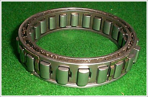

Thanks for all the advice and tips, I checked voltage and ok, the bushes i replaced last summer and did notice the end of the roter shaft (the bit that makes contact with the bushes) was very dirty and worn down, could this be the reason? Anyway i am going to use the 851 startmotor and see if old one can be revised, btw i have changed the bushes 4 times in 12 years, average? btw the first time i had a local dealer do it but after putting repaired starter in the bike would not start, took bike to dealer, he looked and said the sprag clutch was worn :,( took all apart fitted new parts 700 euros, still would not start :banghead: , i noticed when they turned the engine over that everything was turning the wrong way round:wacko:
Who knows what they did wrong? :thumbup: :thumbup: :thumbup: :thumbup:

No, they put the housing from the startmotor the wrong way around and in doing so it changed the polarity of the startmotor making it turn backswards.
Duncati.

:banghead: :banghead: :banghead: Why they didnt MARKED parts, when opened starter ? :wacko:
It is also possible to put sprag clutch wrongly (talking rotation dirtection!), but that must also checked, when taking old one away. (that new one comes same way...) One time i NEAR made just this "mistake" (with my ST4S), but luckily started to think more, what is right turning direction...
