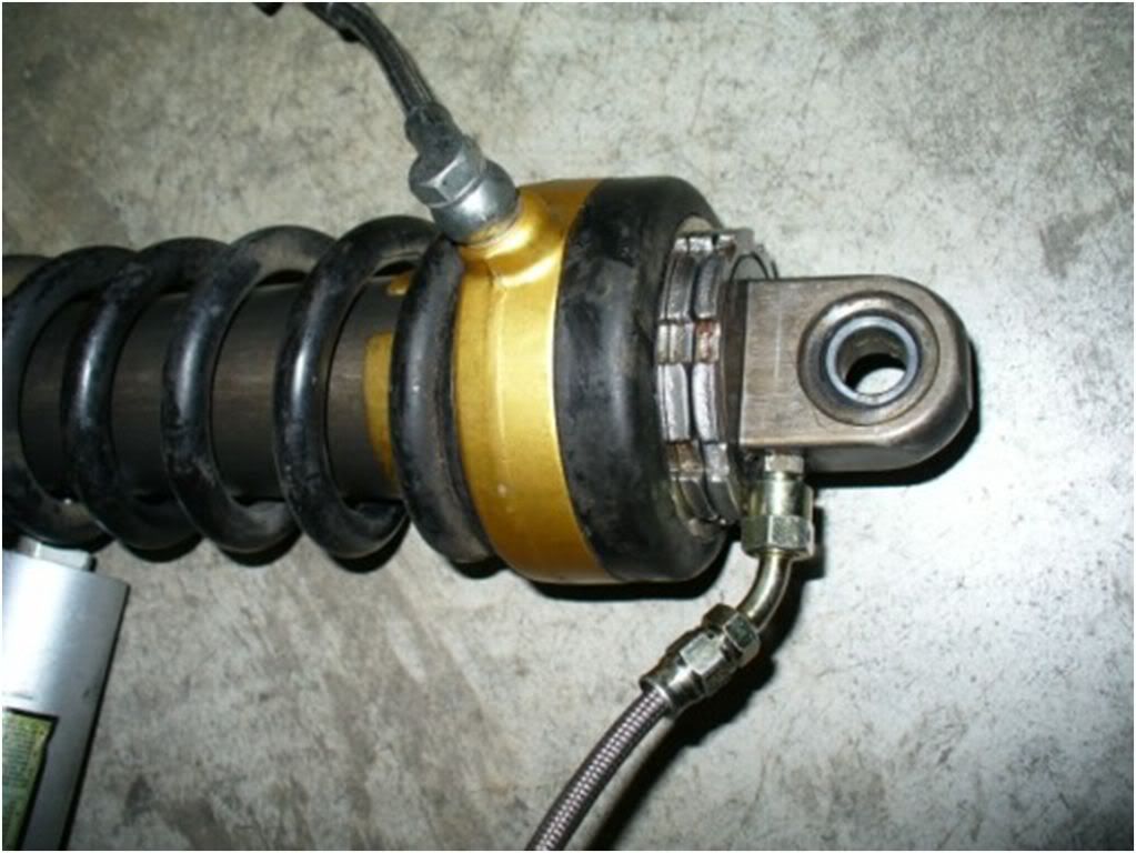

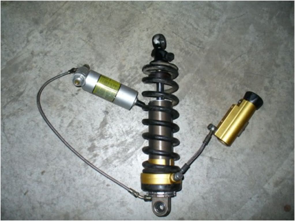

A good friend of mine, Alessandro, here as "nojapan", asked me to show on the forum a very interesting mod to the rear shock.
During the overhauling of the rear shock of his Paso 750, he thought to do an upgrade to add a remote hydraulic adjust on the shock.

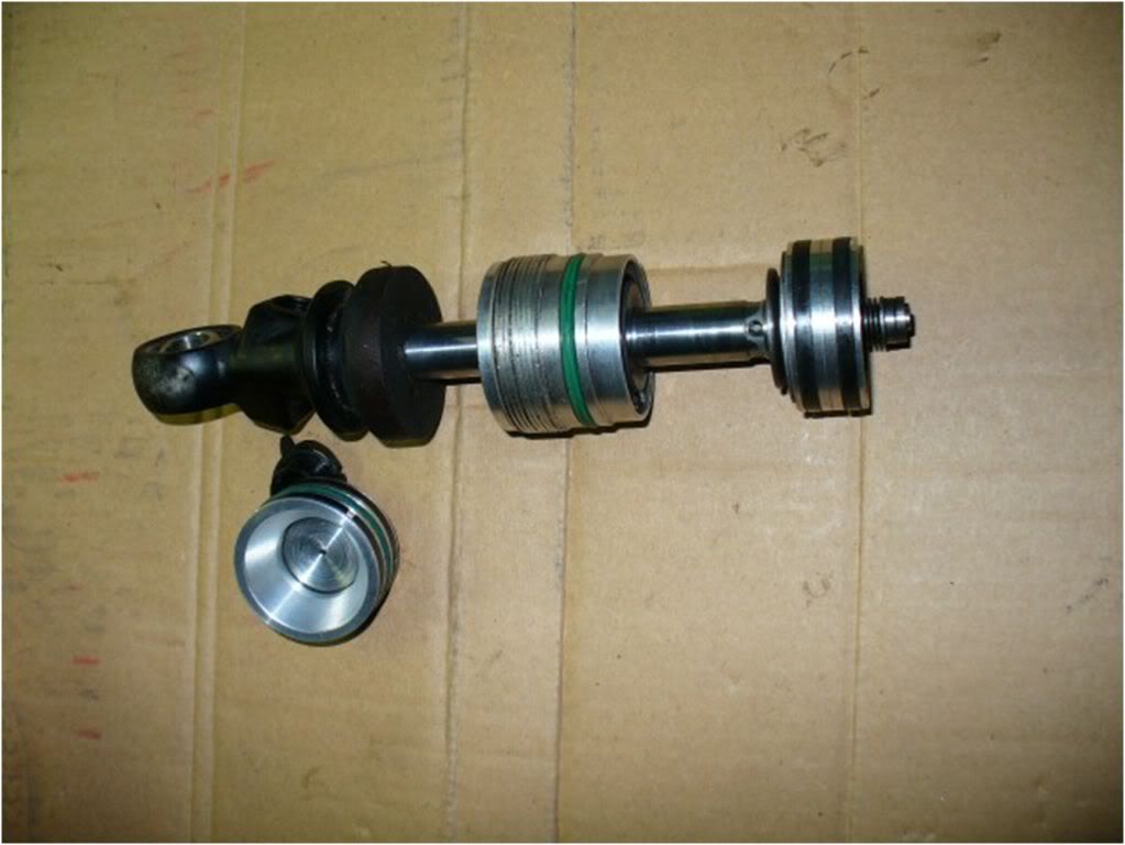

First, it needs to disassemble the shock and remove the piston which separates air and oil.
Now, it musts to enlarge the hole where is located the air-valve, near the highest fixing point of the shock and screw a banjo bolt on it .
So, it needs to connect the hose to the reservoir, fill the body of the shock with oil and bleed the air from the reservoir (he recommends do not inflate air inside first) inflating and then deflating the air, so that all the air bubbles can get away.
Then, it needs to reassemble the shock and remove the oil exceeding (he used 2 parts of SAE 2.5 and 1 SAE 5 oil).
The reservoir has to be inflated about 6-10 atm (he's still testing about the best setting).
The result is very interesting.
He used a Suzuki GSX750R rear shock, bought on ebay for only €. 20.
It has a 16mm. stem, when the Marzocchi has a 14mm. stem, and the alu body is larger than the Marzocchi Duo-Shock, so that the valves are larger, too.
Such mods allow to have a cooler operation but, above all, an hydraulic remote preload adjust on the shock!!!
He spent €. 15 for the oil and €. 20 for the banjo bolt and the braided hose.

wow! this is really intelligent of you fella specially for english roads where the dukes are known for rigid suspesion, I see the adjusters are right down on your photos no need for bending down with a c-spanner now eh? whats the resulting suspension like then?.......desmodave uk.
 Post subject: Re: Hydraulic preload adjust on the rear shock
PostPosted: Wed Oct 21, 2009 2:35 pm
Yes, no need of spanner.
About the results, the friend of mine is still testing the shock.
I hope he will tell us something about personally.

Did your friend have to use any special tools to dismantle the shock body? I had a quick go last year but when the base collar woudn't budge I didn't try further.
http://www.youtube.com/watch?v=jf8Ic_aUWug
PostPosted: Thu Oct 22, 2009 5:25 pm
I will ask him and let you know.
PostPosted: Fri Oct 23, 2009 5:13 pm
I have asked about your question.
First of all, a rectification: only the reservoir is from a Suzuki's shock.
To take the shock apart he has employed this tool:
http://www.beta-tools.com/catalog/artic ... __filters_
Besides, to unscrew the upper ring it needs to warm the body of the shock. Not too much to avoid damages to the dust seal.
