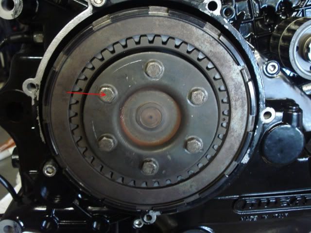

I'm assuming that these are the bolts you are referring to.
Someone correct me if I'm wrong but they should be done up tight,and torqued down
to 9.8 Nm.You should use some thread locker on them as well.
As for the clutch not releasing perhaps you have installed too many plates or it is not bled properly.
The welds on my pressure plate pin broke as well,I carefully ground off the old welds and then fully welded
it back together.It has been in service for nearly 10k km with no sign of cracking.
