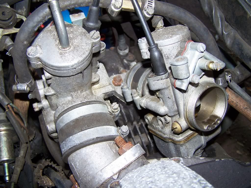

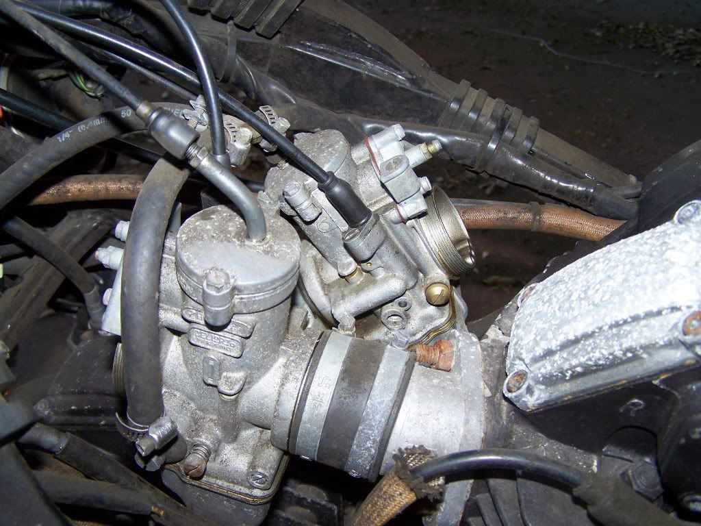

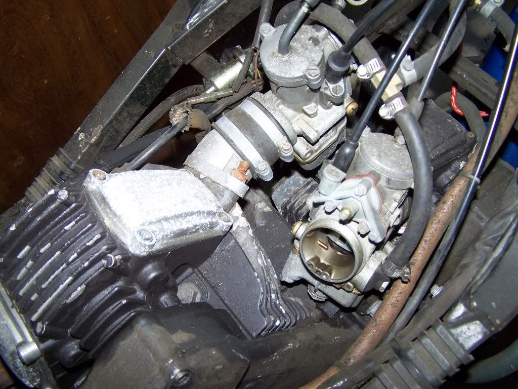

It has Desmo valve action but not fuel injection. Are there 2 separate carbs, one on each cylinder or one carb high up?? A picture or 2 would help :-)

There is one carb on each head. Delorto carbs. How do i tell what size?

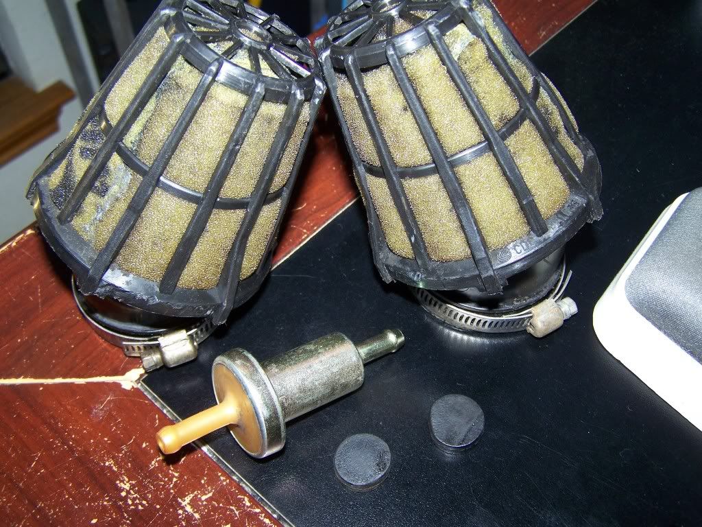

^in this pic is my air filters, fuel filter, and 2 little round rubber things??? Does anyone know if these rubber things are essential? i see them jammed in the exterior cyliner spaces.
Going to pick up a new fuel filter and some tank cleaner today and tomorrow we will run it. Im going to go with por15. Should i bother upgradeing air filters? What is the best oil for these filters? and is there a prefered fuel filter? let me know what you think.

Thanks I guess I will stick them in somewhere. Interestingly enough here is my bike:
