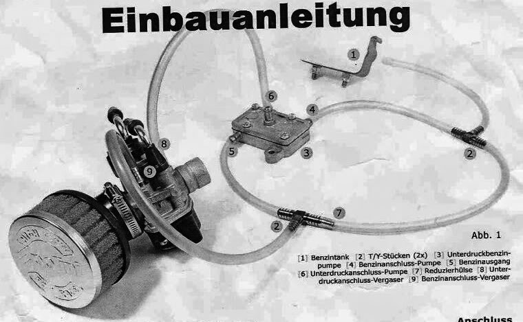

In case your fuel pressure is too high there`re several options like using a fuel pressure regulator, swap the electric fuel pump with an underpressure fuel pump or try a return loop as shown below. "7" is a jet that reduces diameter.
