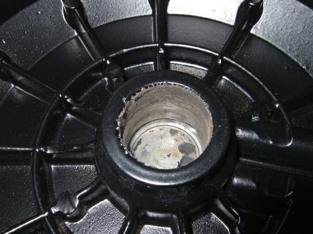

I picked up my clutch covers from the powder coater this morning. They turned out good but it seems the rubber floam plugs he used to plug the clutch cylinders stuck to them when the parts were in the oven. The melted on material should come off by scratching with a small piece of wood. Still there`s always some additional work. :roll: The edge of the powder coat can easily be removed with a scalpel or carpet knife.
