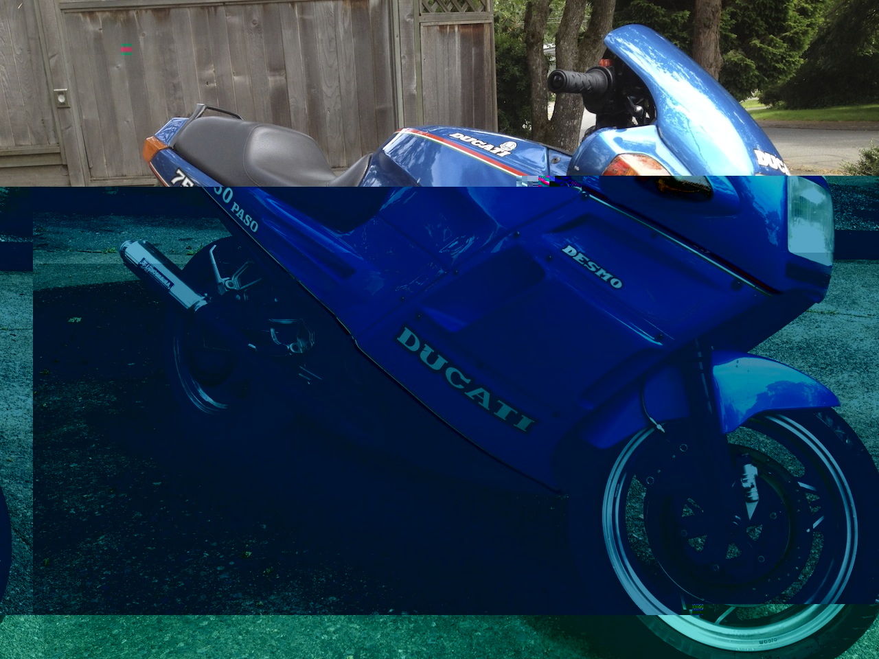

Im sorry for the late reply. The fix to the bike was quick, but I was away from the computer for a few days. WOW! all of these posts are amazing and helpful! I appreciate the advice and learning we get from sharing this bountiful (and pertinent) information with our communities. So thank you all for your posts! I digest, indeed the clutch problem was solved quickly. Upon removal of the clutch cover the clutch basket assemble lay ahead of me, with the spring retainers fastened to torque. After a closer look, and then removing the clutch springs, I could see the 30mm hub nut... loosely laying.... in the basket. So the problem was found, and then solved after a simple re-finishing and installation of the nut, a blast of air to get rid of all that old dust. No damage was done structurally whatsoever, but the inside diameter of the clutch cover suffered some minor scoring from the heads of the spring assembly. Thats why they looked so clean and shiny! Haha. So now the paso is running great, the clutch is strong and smooth, and the weather is beautiful. Lets ride!
Rubber side down gents.
