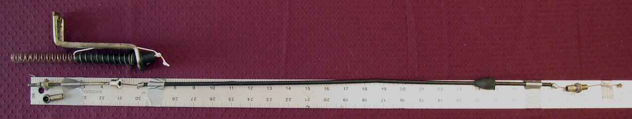

I post every once in a while but have been on the forum for a very long time. Much great knowledge here. Here is my humble offering.

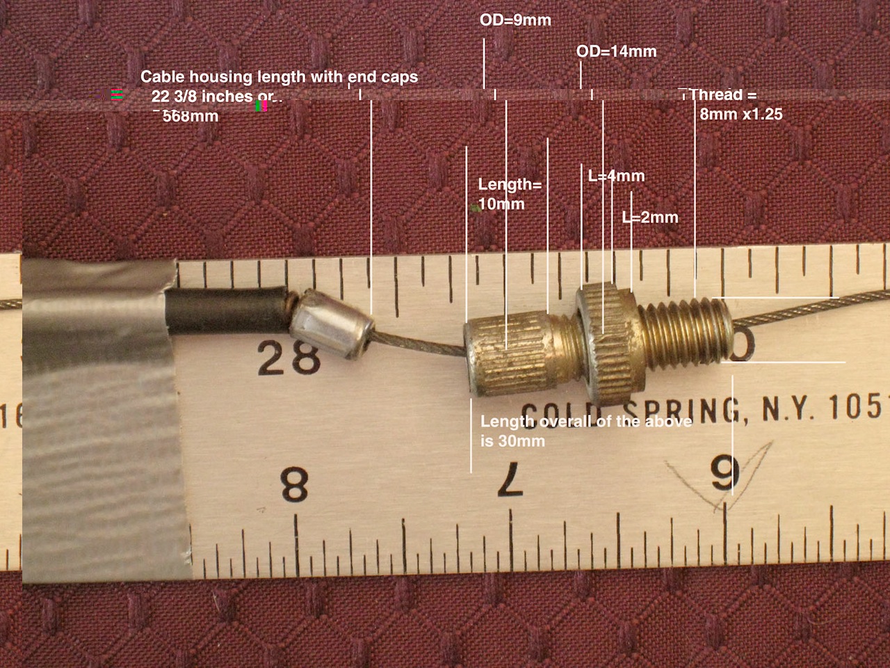

The 750 and 906 throttle cables are the same. Same part number. But you can no longer order them from Ducati. That worried me. I recently bought a used cable from Guzzitech. Great guy, good prices on Paso parts. But the cable is, well used, but in decent condition. It will work just fine if my old one breaks. But part of the reason I bought it, is to measure all the parts. I didn't want to take my existing one of the bike to do this.
So what you have below are photos with notes on the sizes of everything. I'm thinking about the future and how to make up a new cable or at least the critical parts such as cable and cable tube/housing. I hope this helps others with similar thoughts and concerns about their very old throttle cable. Getting the cable, housing and housing end caps, end barrel is easy and easy to assemble. One note, the end opposite the throttle barrel seems to solder into the threaded rod that goes on the Weber end of the cable. Does anyone know that for sure. If it is, you could remove the old cable from that rod and resolder a new cable in.
Anyway, here are the photos. Seems I can only add three at a time, there are six, so I'll add a response to this post with the other three images.

Here's the other three photos of the throttle cable.

It wasn't the size. I had to resize them to 1280 max. I wanted everyone to have details pix. It seems I can only upload three at a time. That's fine. If you know any tricks for that, let me know.
