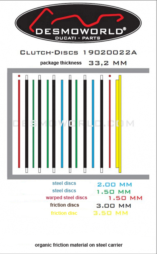

The dots on the steel plates identify the warped discs.
While you have the clutch disassembled measure the thickness of each steel and friction disc and the whole clutch package. Clean the guide pin on the inner side of the pressure plate and grease it (but only very little and remove excessive grease!)
When assembling I`d rotate the outer cutouts of the steel discs by 90 degrees just to prevent a possible inbalance that could occur if they were all ligned up.

19020022a Kopie.jpg [249.28 KiB]
Downloaded 196 times

Thanks Guys,
I guess it doesn't make any difference because I can't find anymarks other than the dot on the drum. Some PO had put both dished plates together all the way to the inside. I can't really see any wear on anything with only 4.9k on the paso so will just clean everything up, space the plate cutouts around the drum and start the bleeding ordeal! Arch.
