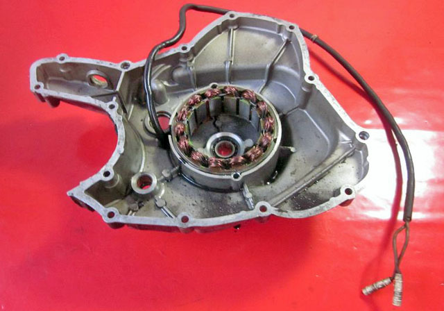

if this helps. The wires coming out of the stator face the cover.

Thanks for the pic. I'm trying to figure out how to keep the wire from ending up in the path of the flywheel. It's a trick keeping it tight against the cover.

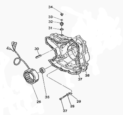

it looks like there is a piece of rubber (#30) which is stuck in the upper gap to hold the wires against the cover.

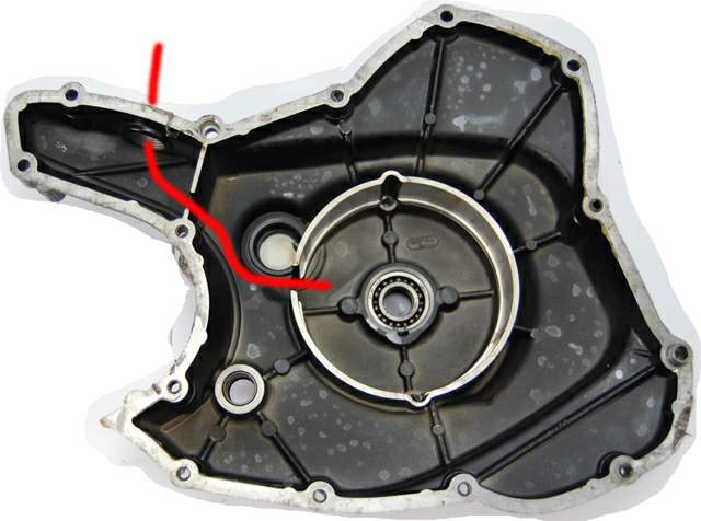

From where the stator is mounted to the gap the wires pass and are held down by that rubber block there are maybe 2 inches. The wires in the rubber tube are not that flexible so where and how would the cable creep ?
All our engine covers are like that.
